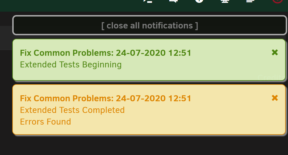

July 24, 20206 yr hi i checked sys logs i made sure usb shares didnt have shares that didnt exisit anymore a bug in Unraid is if you delete shares in krusader it doesnt update it in the ram.. so when you reboot unraid.. it saves those non exisitant shares to the usb so you maybe have 4 shares.. but unraid loads 20 shares you deleted but aside that i cant find what Fix Common Extended scans are finding i cant figure the error mitchflix-diagnostics-20200724-1204.zip

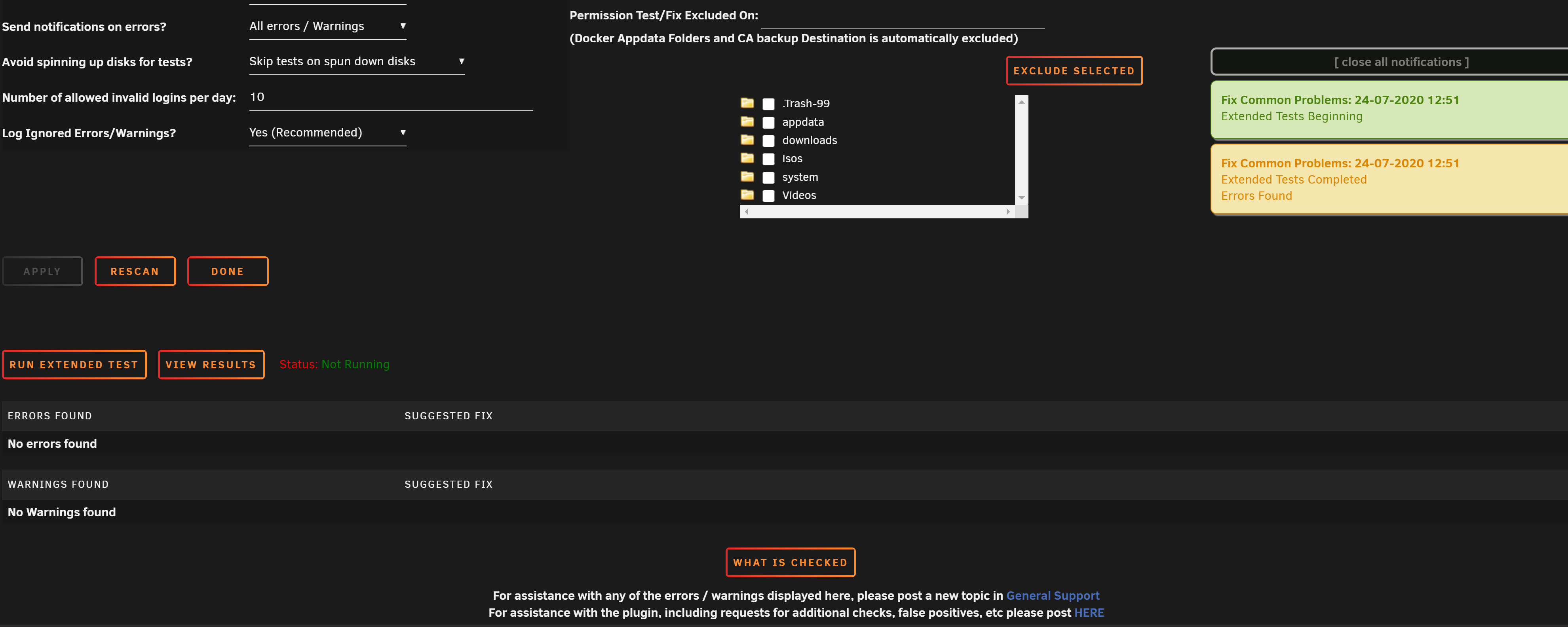

July 25, 20206 yr Author ah ok.. well well yes krusader is an unraid app just like Norton Antivirus is a Windows App or MS Tweak programs that alter windows for you but isnt made by Windows MS and Unraid are the OS Krusdader and Norton antivirus are the OS apps i didnt say krusaider was a Built in Unraid app.. its just a unraid app and isnt a docker and a App (in windows like norton antivirus in the background ) the same thing as for the Parity dont need one this just a media server plus it only has 4 hard drive case parity takes up too much i need to get bigger hard drives to add a parity it its a Acer H340 case 14 yrs old i just upgraded to a m.2 as cache drive instread of a 7200 rpm 1tb usb external as a cache drive as for the results Processing /mnt/user/isos Processing /mnt/user/system Processing /mnt/user/.Trash-99 Processing /mnt/user/Videos The following files / folders may not be accessible to the users allowed via each Share's SMB settings. This is often caused by wrong permissions being used on new downloads / copies by CouchPotato, Sonarr, and the like: /mnt/user/.Trash-99 nobody/nogroup (99/99) 0700 hope that helps.. i guess the issue is with trash then.. wonder how that happens?

July 26, 20206 yr On 7/24/2020 at 6:37 PM, comet424 said: /mnt/user/.Trash-99 nobody/nogroup (99/99) 0700 Non-issue. It's the recycle bin from Krusader
