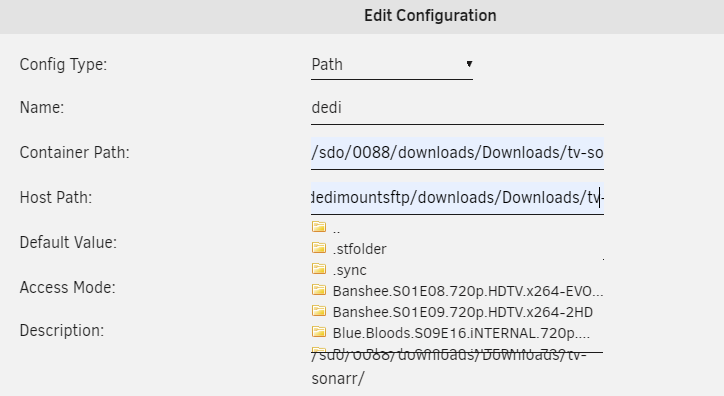

If I browse the share path in the docker templates (this has affected multiple dockers) I can see the full paths and everything is ok but from within the dockers I can only view part of the share?  I have removed the path in the template and re-added it, I have also reboot twice more.
example,
My share path is /mnt/disks/dedimountsftp/downloads/Downloads/tv-sonarr and the template can access this fine but from within the docker I can only see /mnt/disks/dedimountsftp/downloads
Any guidance greatly appreciated!
This is a screenshot of the template for sonarr

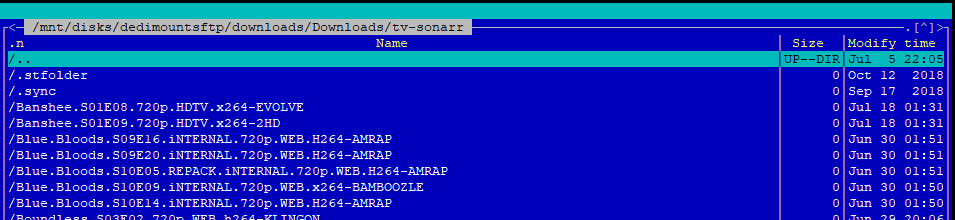

this is the file browser within sonarr
I have just noticed that if I create a new path in the template and point it to an unraid share it works, the problem appears to only be with my rclone mount, really strange! the path has worked for a very long time and is accessable via the path setup in the template, I wonder if the rclone plugin has updated and caused a problem somehow?
I can see the mount perfectly in the unraid console but also noticed I am no longer able to access this mount via my Windows machine any longer either? it is visable via the unraid server in Windows network but if I click it nothing happens, no error just nothing, I have always been able to access this.
