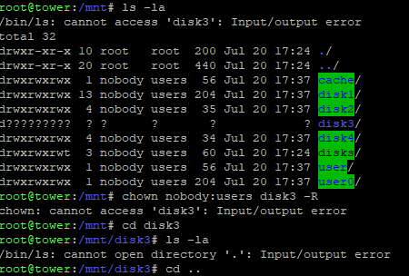

I was unable to create a share or write to an existing share - i got a windows 10 error which there are threads that say this is a windows 10 problem. But then i wasn't able to create a new share either. ( I have a pro license on version 6.8.3 and i resolved this last time by rebooting. this is the second time.)
So I did an LS on the ssh of mount and disk3 had ? and ? for the user and group -
So then i stop the array and put it in maintenance mode and ran a chkdsk -n (the default) and it said said it wasn't going to make any changes but there were errors - so then i took the -n off and it said there was a log it couldn't go back and read/follow so use -L to bypass the log and start over. (this was an empty disk so I went for that option). It said this would be a bad option for keeping data but there was no data on it yet so I didn't care.
That seemed to fix it. It's also not showing any error count, and passes the smart tests too..
Is this disk bad or about to go bad? It is a used 4tb from amazon.  Anyone know what I should look out for or do to troubleshoot this?
It's operational now and back to normal.
Thanks!

Jul 26 21:10:34 tower root:
Jul 26 21:10:34 tower root: /dev/sdg:
Jul 26 21:10:34 tower root:  setting standby to 0 (off)
Jul 26 21:10:35 tower emhttpd: Stopping services...
Jul 26 21:10:35 tower unassigned.devices: Unmounting All Devices...
Jul 26 21:10:36 tower emhttpd: shcmd (35265): /etc/rc.d/rc.samba stop
Jul 26 21:10:37 tower emhttpd: shcmd (35266): rm -f /etc/avahi/services/smb.service
Jul 26 21:10:37 tower emhttpd: shcmd (35268): /etc/rc.d/rc.nfsd stop
Jul 26 21:10:37 tower rpc.mountd[31084]: Caught signal 15, un-registering and exiting.
Jul 26 21:10:38 tower emhttpd: Stopping mover...
Jul 26 21:10:38 tower emhttpd: shcmd (35270): /usr/local/sbin/mover stop
Jul 26 21:10:38 tower kernel: nfsd: last server has exited, flushing export cache
Jul 26 21:10:38 tower root: mover: not running
Jul 26 21:10:38 tower emhttpd: Sync filesystems...
Jul 26 21:10:38 tower emhttpd: shcmd (35271): sync
Jul 26 21:10:38 tower emhttpd: shcmd (35272): rm -f /boot/config/plugins/dynamix/mover.cron
Jul 26 21:10:38 tower emhttpd: shcmd (35273): /usr/local/sbin/update_cron
Jul 26 21:10:38 tower emhttpd: Unmounting disks...
Jul 26 21:10:38 tower root: Stopping diskload
Jul 26 21:10:38 tower kernel: mdcmd (162): stop
Jul 26 21:10:38 tower kernel: md1: stopping
Jul 26 21:10:38 tower kernel: md2: stopping
Jul 26 21:10:38 tower kernel: md3: stopping
Jul 26 21:10:38 tower kernel: md4: stopping
Jul 26 21:10:39 tower emhttpd: Starting services...
Jul 26 21:10:39 tower emhttpd: shcmd (35278): /etc/rc.d/rc.samba start
Jul 26 21:10:39 tower root: Starting Samba:  /usr/sbin/smbd -D
Jul 26 21:10:39 tower root:                  /usr/sbin/nmbd -D
Jul 26 21:10:39 tower root:                  /usr/sbin/wsdd
Jul 26 21:10:39 tower root:                  /usr/sbin/winbindd -D
Jul 26 21:10:39 tower emhttpd: shcmd (35279): cp /tmp/emhttp/smb.service /etc/avahi/services/smb.service
Jul 26 21:10:39 tower emhttpd: shcmd (35281): /etc/rc.d/rc.nfsd start
Jul 26 21:10:39 tower root: Starting NFS server daemons:
Jul 26 21:10:39 tower root:   /usr/sbin/exportfs -r
Jul 26 21:10:39 tower root:   /usr/sbin/rpc.nfsd 8
Jul 26 21:10:39 tower root:   /usr/sbin/rpc.mountd
Jul 26 21:10:39 tower rpc.mountd[1052]: Version 2.1.1 starting
Jul 26 21:10:39 tower emhttpd: no mountpoint along path: /mnt/user/system/docker
Jul 26 21:10:39 tower emhttpd: no mountpoint along path: /mnt/user/system/libvirt
Jul 26 21:10:46 tower kernel: mdcmd (163): set md_num_stripes 1280
Jul 26 21:10:46 tower kernel: mdcmd (164): set md_queue_limit 80
Jul 26 21:10:46 tower kernel: mdcmd (165): set md_sync_limit 5
Jul 26 21:10:46 tower kernel: mdcmd (166): set md_write_method
Jul 26 21:10:46 tower kernel: mdcmd (167): set spinup_group 0 0
Jul 26 21:10:46 tower kernel: mdcmd (168): set spinup_group 1 0
Jul 26 21:10:46 tower kernel: mdcmd (169): set spinup_group 2 0
Jul 26 21:10:46 tower kernel: mdcmd (170): set spinup_group 3 0
Jul 26 21:10:46 tower kernel: mdcmd (171): set spinup_group 4 0
Jul 26 21:10:46 tower kernel: mdcmd (172): start STOPPED
Jul 26 21:10:46 tower kernel: unraid: allocating 31110K for 1280 stripes (6 disks)
Jul 26 21:10:46 tower kernel: md1: running, size: 3907018532 blocks
Jul 26 21:10:46 tower kernel: md2: running, size: 3907018532 blocks
Jul 26 21:10:46 tower kernel: md3: running, size: 3907018532 blocks
Jul 26 21:10:46 tower kernel: md4: running, size: 976762552 blocks
Jul 26 21:10:46 tower emhttpd: shcmd (35301): udevadm settle
Jul 26 21:10:47 tower root: Starting diskload
Jul 26 21:10:48 tower tips.and.tweaks: Tweaks Applied
Jul 26 21:10:48 tower emhttpd: Mounting disks...
Jul 26 21:10:48 tower emhttpd: shcmd (35308): /sbin/btrfs device scan
Jul 26 21:10:49 tower root: Scanning for Btrfs filesystems
Jul 26 21:10:49 tower emhttpd: shcmd (35309): mkdir -p /mnt/disk1
Jul 26 21:10:49 tower emhttpd: shcmd (35310): mount -t xfs -o noatime,nodiratime /dev/md1 /mnt/disk1
Jul 26 21:10:49 tower kernel: XFS (md1): Mounting V5 Filesystem
Jul 26 21:10:50 tower kernel: XFS (md1): Ending clean mount
Jul 26 21:10:50 tower emhttpd: shcmd (35311): xfs_growfs /mnt/disk1
Jul 26 21:10:50 tower root: meta-data=/dev/md1               isize=512    agcount=4, agsize=244188659 blks
Jul 26 21:10:50 tower root:          =                       sectsz=512   attr=2, projid32bit=1
Jul 26 21:10:50 tower root:          =                       crc=1        finobt=1, sparse=1, rmapbt=0
Jul 26 21:10:50 tower root:          =                       reflink=1
Jul 26 21:10:50 tower root: data     =                       bsize=4096   blocks=976754633, imaxpct=5
Jul 26 21:10:50 tower root:          =                       sunit=0      swidth=0 blks
Jul 26 21:10:50 tower root: naming   =version 2              bsize=4096   ascii-ci=0, ftype=1
Jul 26 21:10:50 tower root: log      =internal log           bsize=4096   blocks=476930, version=2
Jul 26 21:10:50 tower root:          =                       sectsz=512   sunit=0 blks, lazy-count=1
Jul 26 21:10:50 tower root: realtime =none                   extsz=4096   blocks=0, rtextents=0
Jul 26 21:10:50 tower emhttpd: shcmd (35312): mkdir -p /mnt/disk2
Jul 26 21:10:50 tower emhttpd: shcmd (35313): mount -t xfs -o noatime,nodiratime /dev/md2 /mnt/disk2
Jul 26 21:10:50 tower kernel: XFS (md2): Mounting V5 Filesystem
Jul 26 21:10:50 tower kernel: XFS (md2): Ending clean mount
Jul 26 21:10:50 tower emhttpd: shcmd (35314): xfs_growfs /mnt/disk2
Jul 26 21:10:50 tower root: meta-data=/dev/md2               isize=512    agcount=4, agsize=244188659 blks
Jul 26 21:10:50 tower emhttpd: shcmd (35315): mkdir -p /mnt/disk3
Jul 26 21:10:50 tower emhttpd: shcmd (35316): mount -t xfs -o noatime,nodiratime /dev/md3 /mnt/disk3
Jul 26 21:10:50 tower kernel: XFS (md3): Mounting V5 Filesystem
Jul 26 21:10:50 tower kernel: XFS (md3): Ending clean mount
Jul 26 21:10:50 tower emhttpd: shcmd (35317): xfs_growfs /mnt/disk3
Jul 26 21:10:50 tower root: meta-data=/dev/md3               isize=512    agcount=16, agsize=61047660 blks
Jul 26 21:10:50 tower root: data     =                       bsize=4096   blocks=976754633, imaxpct=25
Jul 26 21:10:50 tower root: log      =internal log           bsize=4096   blocks=119233, version=2
Jul 26 21:10:50 tower emhttpd: shcmd (35318): mkdir -p /mnt/disk4
Jul 26 21:10:50 tower emhttpd: shcmd (35319): mount -t xfs -o noatime,nodiratime /dev/md4 /mnt/disk4
Jul 26 21:10:50 tower kernel: XFS (md4): Mounting V5 Filesystem
Jul 26 21:10:51 tower kernel: XFS (md4): Ending clean mount
Jul 26 21:10:51 tower emhttpd: shcmd (35320): xfs_growfs /mnt/disk4
Jul 26 21:10:51 tower root: meta-data=/dev/md4               isize=512    agcount=4, agsize=61047660 blks
Jul 26 21:10:51 tower root:          =                       sectsz=512   attr=2, projid32bit=1
Jul 26 21:10:51 tower root:          =                       crc=1        finobt=1, sparse=1, rmapbt=0
Jul 26 21:10:51 tower root:          =                       reflink=1
Jul 26 21:10:51 tower root: data     =                       bsize=4096   blocks=244190638, imaxpct=25
Jul 26 21:10:51 tower root:          =                       sunit=0      swidth=0 blks
Jul 26 21:10:51 tower root: naming   =version 2              bsize=4096   ascii-ci=0, ftype=1
Jul 26 21:10:51 tower root: log      =internal log           bsize=4096   blocks=119233, version=2
Jul 26 21:10:51 tower root:          =                       sectsz=512   sunit=0 blks, lazy-count=1
Jul 26 21:10:51 tower root: realtime =none                   extsz=4096   blocks=0, rtextents=0
Jul 26 21:10:51 tower emhttpd: shcmd (35321): mkdir -p /mnt/cache
Jul 26 21:10:51 tower emhttpd: cache uuid: 6fa7d622-ac1b-44ae-8468-bb4483c2e842
Jul 26 21:10:51 tower emhttpd: cache TotDevices: 2
Jul 26 21:10:51 tower emhttpd: cache NumDevices: 2
Jul 26 21:10:51 tower emhttpd: cache NumFound: 2
Jul 26 21:10:51 tower emhttpd: cache NumMissing: 0
Jul 26 21:10:51 tower emhttpd: cache NumMisplaced: 0
Jul 26 21:10:51 tower emhttpd: cache NumExtra: 0
Jul 26 21:10:51 tower emhttpd: cache LuksState: 0
Jul 26 21:10:51 tower emhttpd: shcmd (35322): mount -t btrfs -o noatime,nodiratime -U 6fa7d622-ac1b-44ae-8468-bb4483c2e842 /mnt/cache
Jul 26 21:10:51 tower kernel: BTRFS info (device sdh1): disk space caching is enabled
Jul 26 21:10:51 tower kernel: BTRFS info (device sdh1): has skinny extents
Jul 26 21:10:51 tower kernel: BTRFS info (device sdh1): enabling ssd optimizations
Jul 26 21:10:51 tower emhttpd: shcmd (35323): /sbin/btrfs filesystem resize 1:max /mnt/cache
Jul 26 21:10:51 tower root: Resize '/mnt/cache' of '1:max'
Jul 26 21:10:51 tower emhttpd: shcmd (35324): /sbin/btrfs filesystem resize 2:max /mnt/cache
Jul 26 21:10:51 tower kernel: BTRFS info (device sdh1): resizing devid 1
Jul 26 21:10:51 tower kernel: BTRFS info (device sdh1): new size for /dev/sdh1 is 525112680448
Jul 26 21:10:51 tower kernel: BTRFS info (device sdh1): resizing devid 2
Jul 26 21:10:51 tower kernel: BTRFS info (device sdh1): new size for /dev/sdg1 is 480103948288
Jul 26 21:10:51 tower root: Resize '/mnt/cache' of '2:max'
Jul 26 21:10:51 tower emhttpd: shcmd (35325): sync
Jul 26 21:10:52 tower emhttpd: shcmd (35326): mkdir /mnt/user0
Jul 26 21:10:52 tower emhttpd: shcmd (35327): /usr/local/sbin/shfs /mnt/user0 -disks 30 -o noatime,allow_other  |& logger
Jul 26 21:10:52 tower shfs: use_ino: 1
Jul 26 21:10:52 tower shfs: direct_io: 0
Jul 26 21:10:52 tower emhttpd: shcmd (35328): mkdir /mnt/user
Jul 26 21:10:52 tower emhttpd: shcmd (35329): /usr/local/sbin/shfs /mnt/user -disks 31 2048000000 -o noatime,allow_other -o remember=330  |& logger
Jul 26 21:10:52 tower emhttpd: shcmd (35331): /usr/local/sbin/update_cron
Jul 26 21:10:52 tower root: Creating custom tabs
Jul 26 21:10:52 tower sudo:     root : TTY=unknown ; PWD=/ ; USER=root ; COMMAND=/usr/bin/env python /usr/bin/denyhosts.py --daemon --config=/boot/config/plugins/denyhosts/denyhosts.cfg
