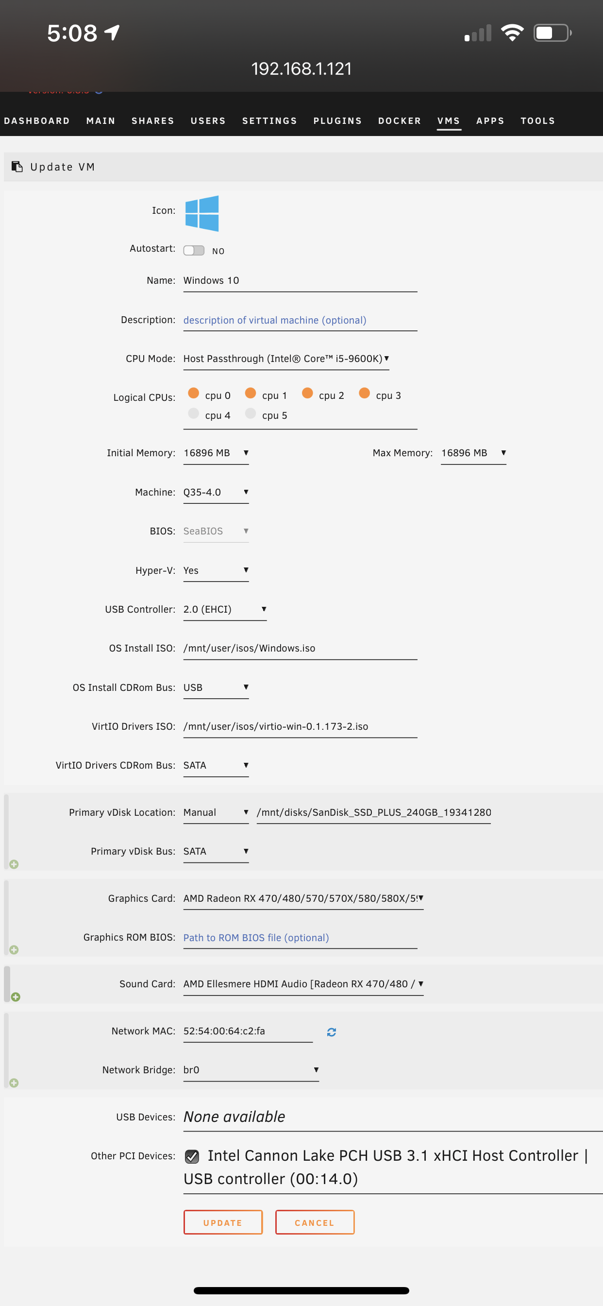

photo is current vm settings.
Did you try rebooting the server? The RX570 has reset issue so all the problems could just be it wasn't reset properly.
Also considering the 9600K has an IGPU, you probably want to set your motherboard to boot with the iGPU and then dump your own vbios for the RX570. That may (or may not) help with the reset issue.
Changing machine type needs a brand new template from scratch. Changing it on the GUI isn't gonna work due to the complex changes from PCI to PCIe.
