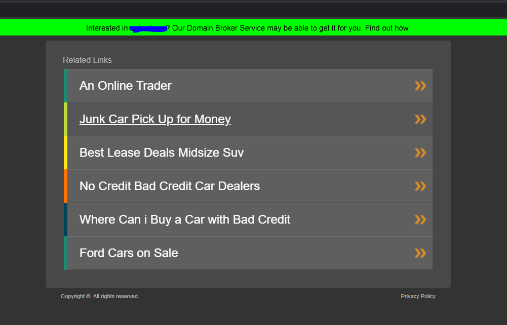

This works! Thank you! On a different note, when I go to my site without putting "www" in the www.example.com, I get to the following site instead.

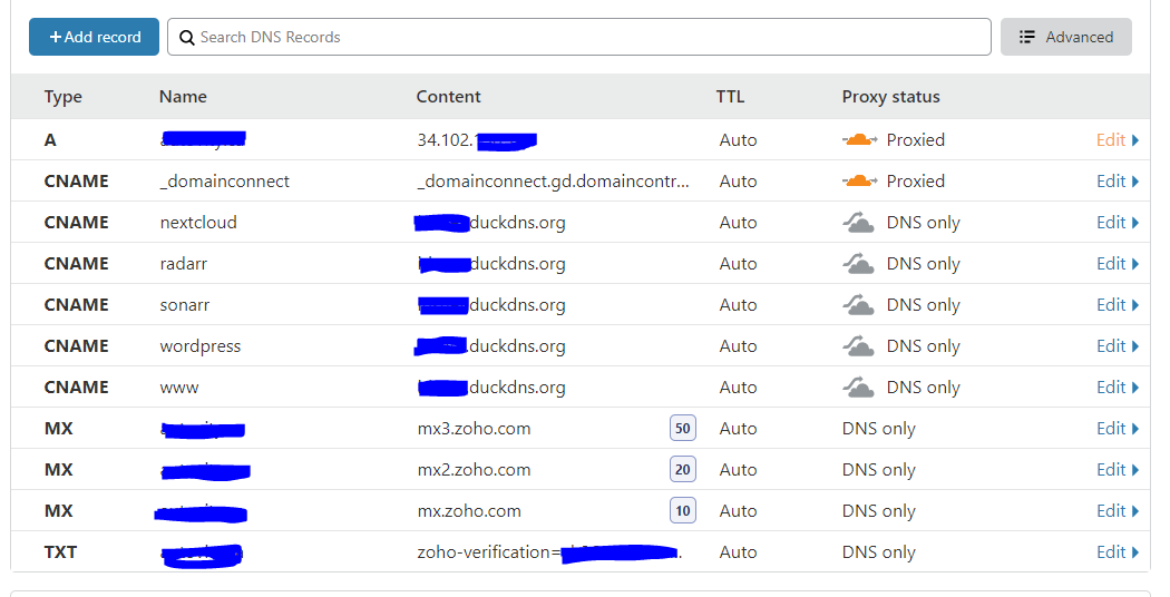

My cloudflare for the A record is as follows:
I do not know where this A record points to. Since I do not have a permanet IP, I can't really change this A record IP (unless there is a way). Cloudflare only allows a static IP in there.
Is the A record causing this or is there something I can do in the nginx config?

I'm not sure how cloudflare determines the A record.
What you can try is to get the API code from cloudflare and install the cloudflare docker from the Unraid app store which will do DDNS for you (instead of relying on duckdns).
That may resolve the A record issue (if cloudflare is smart enough to update the A record to the dynamic IP).
super! Thank you for all the help. I also generated domain level cert and now not getting any cert error either.
