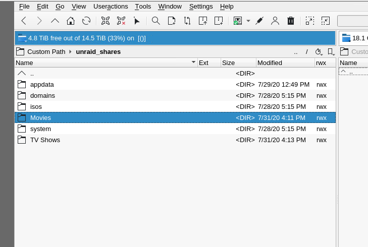

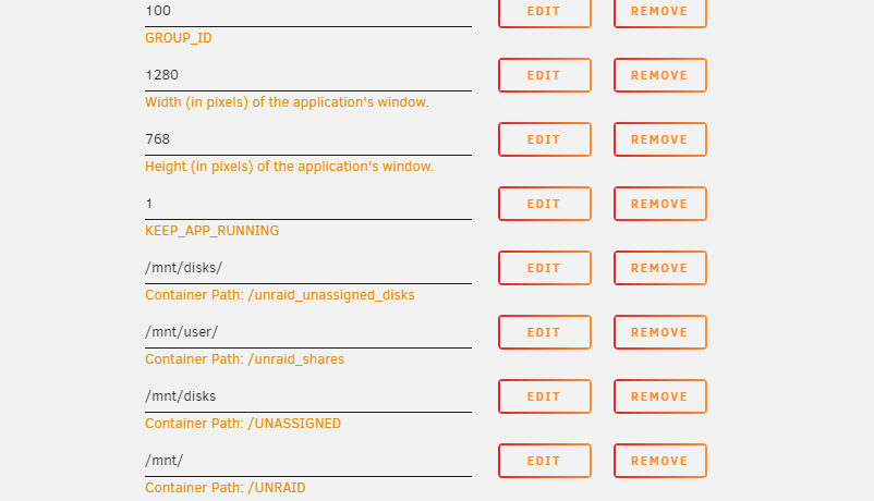

So i created a share named Movies and a share named TV Shows. I have data in these shares, I cannot find the path to these shares in Plex.  According to Krusader Is looks like they are in unraid_shares which is a container I set up in Krusader. The host path is /mnt/user
The container path is /unraid_shares.  I cannot find the movies in plex when i browse for a folder, what am i missing?  Shouldn't this be /mnt/user/unraid_shares/Movies.
I am new to Unraid OS so be kind when you point out what i missed.

First of all, plex and krusader are completely separate containers, completely isolated from each other. There is no reason for the paths in one to be similar to the paths in the other unless you have specifically made it that way.
Your screenshots seem like they both may be about krusader, but you are asking a question about accessing files in plex. Totally unrelated.
