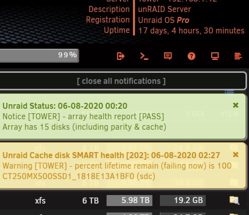

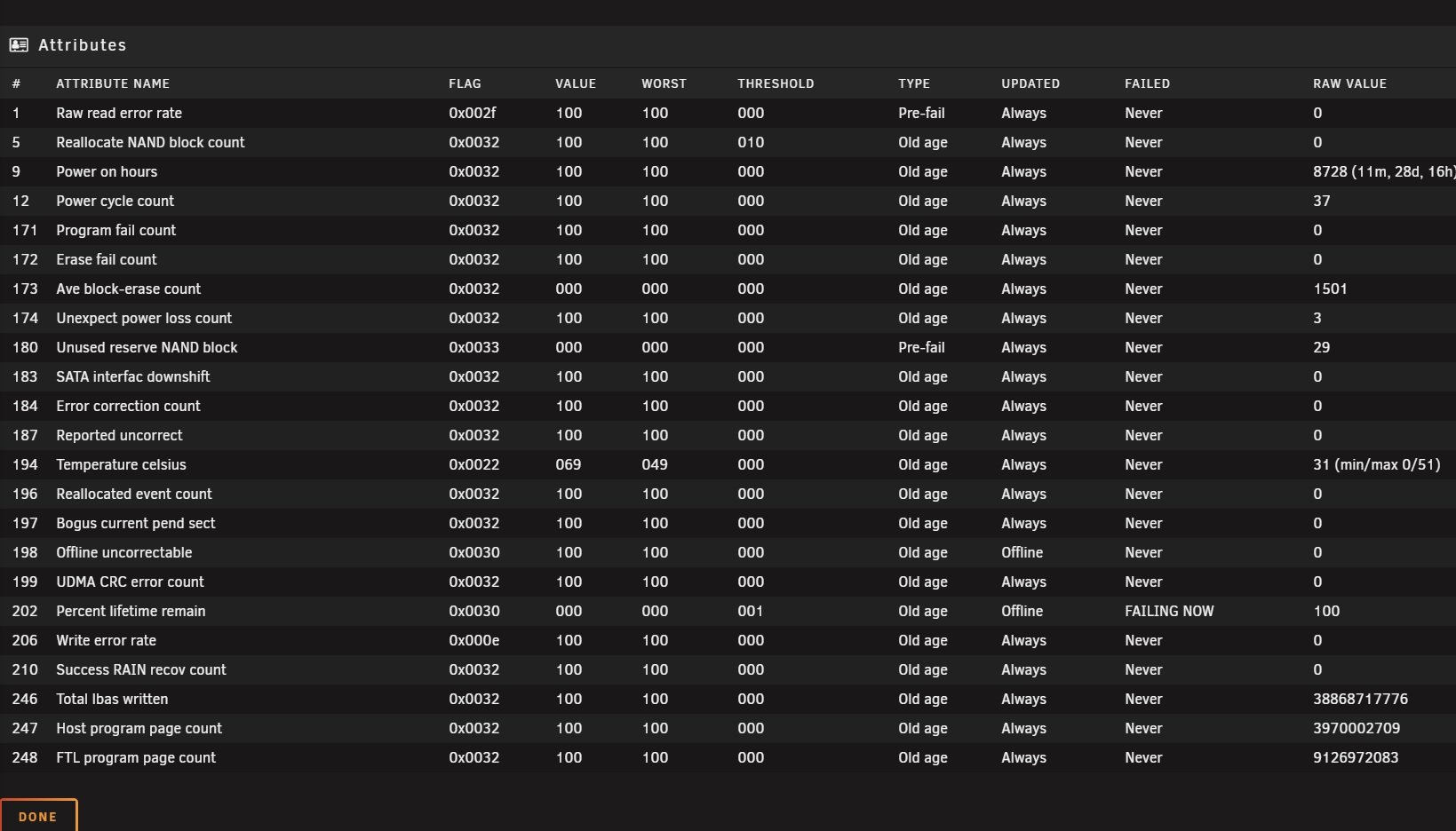

Here are 2 screenshots showing the warning notification from the main page and the other is the SMART data shown when click on "cache" in the main page.  It's now up to 100.
Looks like a firmware bug to me, 20TBW is nowhere close the expected life for that SSD, as a comparison where's one from an MX500 500GB, with around 90TB written it's at 50% expected life:

That part is OK, normalized value is remaining life, raw value is spent life, this is from an almost new MX 500:
