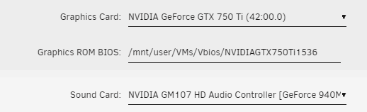

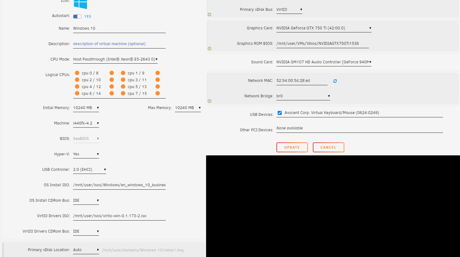

I am trying to get a GeForce GTX 750 Ti to do passthrough on a Windows 10 VM. Using the VNC works fine but when I use the GPU I see nothing but a blank screen.
I am using the GPU as both the soundcard and GPU.
IOMMU: Enabled
>Nothing extra is in the IOMMU group:
IOMMU group 38:    [10de:1380] 42:00.0 VGA compatible controller: NVIDIA Corporation GM107 [GeForce GTX 750 Ti] (rev a2)
[10de:0fbc] 42:00.1 Audio device: NVIDIA Corporation GM107 High Definition Audio Controller [GeForce 940MX] (rev a1)
I also tried some tricks from Spaceinvader One to include editing the xml file.
<driver name='vfio'/>
      <source>
        <address domain='0x0000' bus='0x42' slot='0x00' function='0x0'/>
      </source>
      <rom file='/mnt/user/VMs/Vbios/NVIDIAGTX750Ti1536'/>
    </hostdev>

2 hours ago, Unraid Newbie said:
 <rom file='/mnt/user/isos/Asus-GTX750Ti.Edited.rom'/>
I too edited my xml as you did. I noticed my edit did NOT have .rom at the end so I changed the extension to that and added it in the xml. Booted with no issues but still not getting any display. I will keep digging in what you posted and elsewhere.
@Gobananas
@Unraid Newbie
In both the above cases, the xml for the video devices have not been edited correctly. This may not be the root cause, but there are a number of steps you can follow for best results.
Check out the link in my sig and come back with the suggested deayils once you’ve exhausted those steps.
On 8/6/2020 at 4:07 PM, meep said:
@Gobananas
@Unraid Newbie
Thank you for the advise meep. After going over your amazing guide and solving many other puzzles like getting virt-manager to work. I am still not sure on what is going on. Virt-manager simply shows a blank screen. Nothing more. I moved the GPU to another PC to confirm it was working and it had no trouble at all. Still I grabbed 2 1100w power supplies so I could upgrade the GPU to a Geforce 680. Once I get the new power supplies I am going to start off again from the "Click 'Add Hardware' and choose Graphics to add a Spice or VNC adapter." ( Meeps guide: https://mediaserver8.blogspot.com/2020/07/problems-passing-through-gpu-to-unraid.html). I will post again my results.
