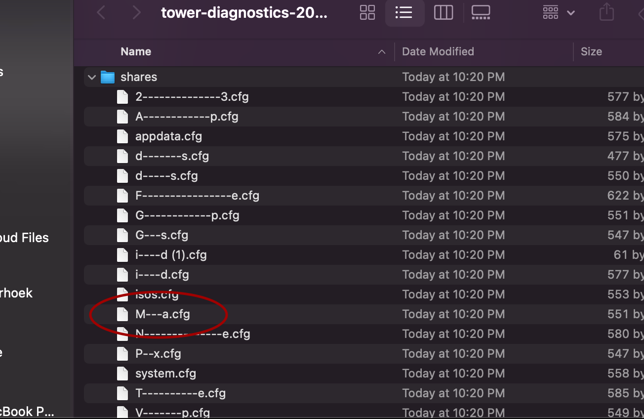

Yeah, the primary function of this machine was as a Plex Server. My media was 8+Tb of the available 16Tb array. See the attached screenshot for what I think was my Media share. The only thing I can think of is that Plex had read/write access, so someone in my house may have deleted files that way.... but as far as I'm aware, that has to be done file by file, not a whole folder structure at a time.
That screenshot is what I was looking at in your diagnostics when I said
13 hours ago, trurl said:
there was a share that might have been name Media and it doesn't exist anymore
If you open up that file that you have circled in red you will see it says it exists on no drives.
