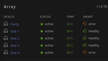

I'm a happy Unraid user, but i have 2 hdds with problems.
Parity, disk 1 and 2 is 4tb, and disk 3 and 4 3tb.

Not all SMART errors are equally problematic, and many don't even correlate with the drive failing. What exactly are the errors?
Tools, diagnostics, attach the zip file to your next post in this thread if you want someone to look the situation over for you.
CRC errors are not disk errors, they are connection problems. According to your syslog you may also be having connection problems with cache.
Check all connections, SATA and power, both ends, including splitters.
CRC errors won't reset, but you can acknowledge them on the Dashboard by clicking on the warning, and it will not warn again unless they increase.

Thanks for the reply.
I know crc errors its connections, but they appear after energy goes down few times.
I can RMA both HDD without problems, and replace them.
Appdata i have configured Prefer, should swap to Only in cache?

Replacing disks won't help. Get an UPS.
Leave as Prefer. Disable Dockers in Settings then run Mover

I'll move unraid server to another location and will buy an UPS.
Will run mover asap.
And my first question, how to proceed to swap parity hdd?
Stop array, remove parity hdd, start array, stop array, assign new 8Tb (precleaned) and start array?
Edited by Vitor Ventura
Just assign the new disk to the parity slot and start the array to build parity
