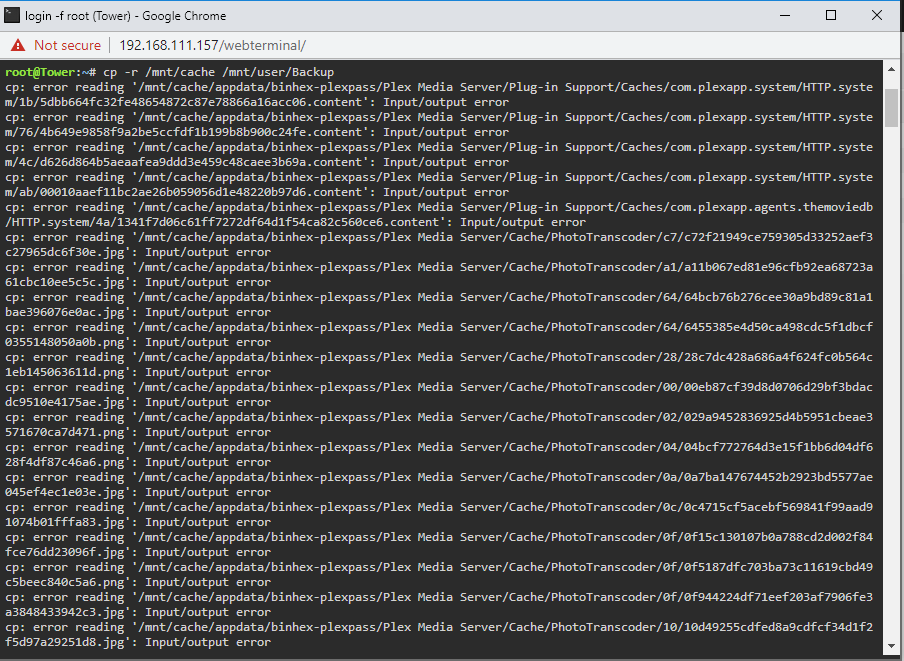

ok, so I ran:
cp -r /mnt/cache /mnt/user/Backup
Looks like every file got an error as shown in the attached image.  Unsure if this is because of permissions or a general read error on the cache drive?
Those errors are likely the result of data corruption, btrfs will give an i/o error if corruption is detected so that you're not fed bad data without knowing, would need diags to confirm, if it's that you can use btrfs restore to bypass it, but data will still be corrupt.

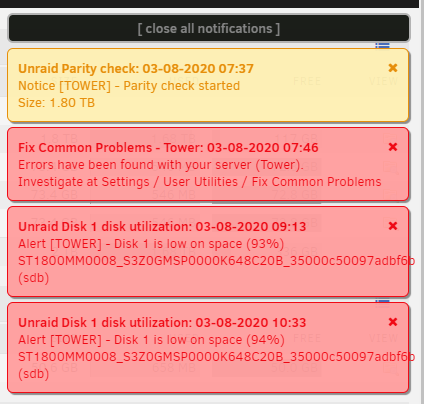

After using that process to copy the files over - I have a lot of these errors.  What is the next step in the process?
Nothing as long as the data fits on disk1, if it doesn't you'll need to use another disk with more space.
Also good idea to cancel/pause the parity check for nw.
