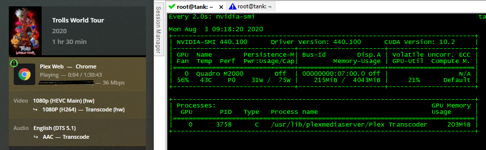

August 3, 20206 yr Author Awesome, and thanks for quick responses! It appears I have more homework to-do. I am okay with building a kernel, assuming there is an idiot 101 guide for special ol' me. I will test out the plugin, this setup currently is not mission critical, I am open to failure and learning. I have a primary system for everything else. EDIT :: -N- :: UPDATE I hurried home, as fast as I could! Alright, so far so good. Oh boy, were getting somewhere! Yay!!! Success! Thanks again to @testdasi, it truly was a Viola'! moment on beta 25, took less then 10 minutes including shutdown, and restarting of the server. !! Edited August 3, 20206 yr by tbonedude420 updates
