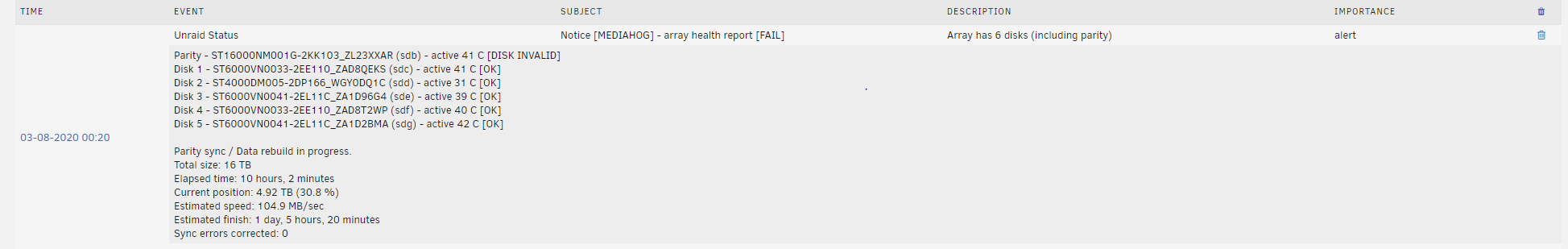

I am running parity for the first time and not doing anything else while it does this. I awoke this morning to see parity is still running but there was a red error notification from 00:20 stating [Notice MediaHog] - array health report [FAIL]
I looked at he logs but could find nothing more. I then went to the Archived Notifications tool and found this, see attached pic.
Is it failing because parity isn't complete yet?
Yep.
Ok thanks for confirmation, I will stop freaking out now.
