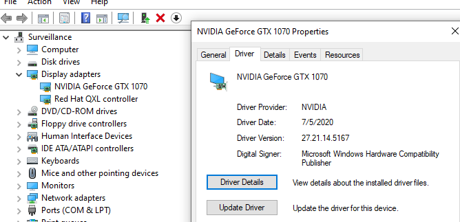

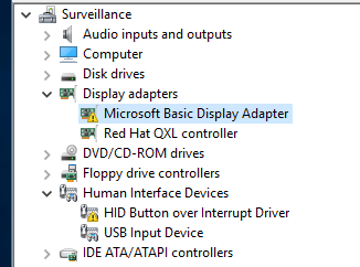

This is how it presents in windows:

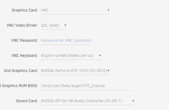

here is my relevant part of the VM Config:

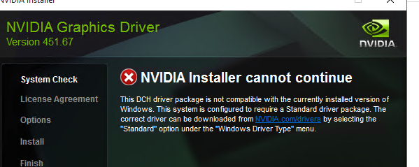

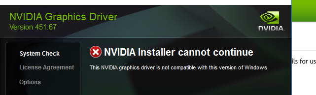

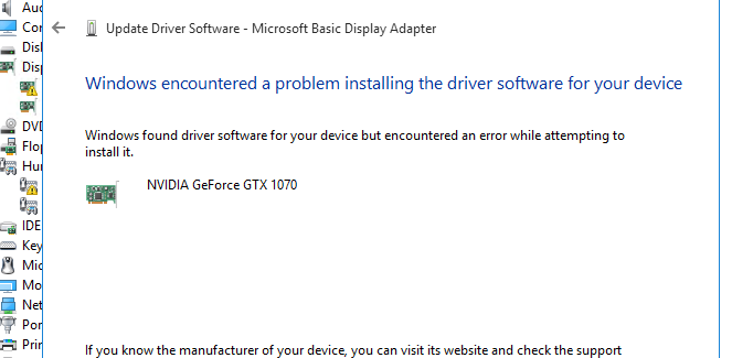

when attempting to install nvidia drivers through windows, I get this:
and when I try through nvidia:
and if I follow those instructions:
Windows Version:

If you check the properties in device manager for the basic display adapter, you’ll likely find a -43 error.
nvidia drivers do not play nice when they detect the host is a vm.
please check the steps outlined in the link in my sig to get started resolving this.
This is what I got:
This device is not working properly because Windows cannot load the drivers required for this device. (Code 31)

I also just realized that I was installing the RTM version of windows 10.... that could have been an issue.
it was, in fact, the RTM version that was causing the issue... installed the 1909 version and it worked.

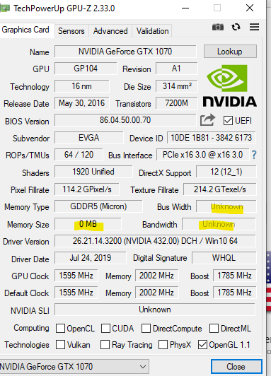

ok, after upgrading to 6.9.0-beta25, and using Windows 10 2004, It showed correcly as above, but is not functional within the VM. Here is what GPU-Z shows:
it shows 0 memory here, and 4GB memory elsewhere. its an 8GB card. I am using the correct ROM. EVGA 1070 SC ACX 3.0
