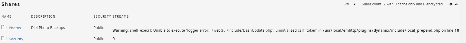

I left the system running and it stopped working again.  This time, the following error occured:
Warning: shell_exec(): Unable to execute 'logger error: '/webGui/include/DashUpdate.php;: ininitialized csrf_token' in /user/local/emhttp/plugins/dynamix/include/local_prepend.php on line 18
I scanned the USB drive and no errors found.  I'll try scan all the drives, but that may take a while.

The only way that has been found thus far to get an unitialized csrf_token is if (probably due to a misconfigured docker app) the RAM (rootfs) completely fills up.  The diagnostics are after a reboot, so not much of any use there.
Watch the dashboard, and when the log / used memory goes up significantly, post new diagnostics.
