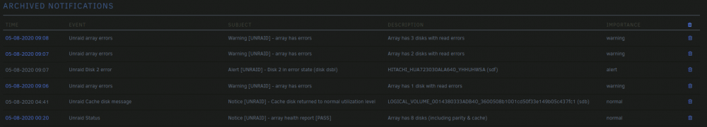

I had yesterday errors on one of the array disks, it was marked as disabled and array failed
This is brand new disk so I restarted the server, attached this drive to array again and rebuild it - it went OK, all data was restored, the array was working again... for 24 hours

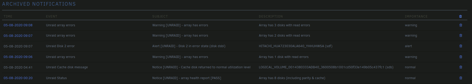

Today in the morning I got more error messages, so now it's 3 disks with errors, what the hell is happening here?
Can you help me sort this out?

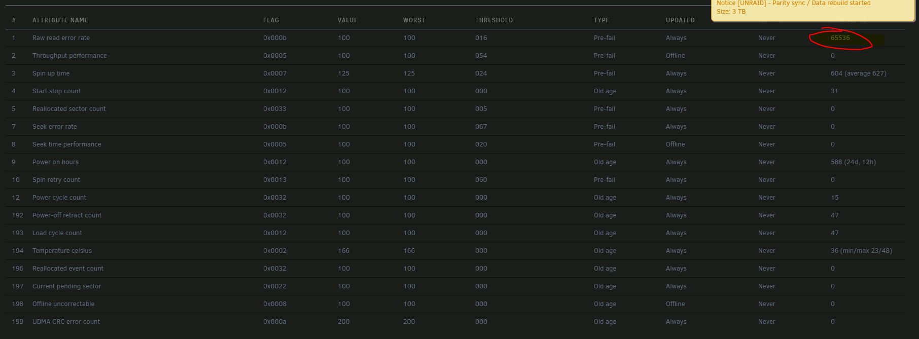

Yes, assuming the disk is healthy, there are no SMART reports on the diags posted, you'll need to power cycle or reboot, also make sure the emulated disk is mounting correctly and contents look OK before rebuilding on top.
