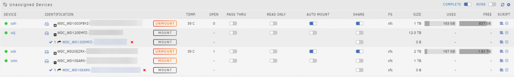

Hi there! I have been using UnRaid for awhile already, and I have 2 idle disks would like to preclear them first. iirc, I did once to them but I am not sure so I would like to preclear them again. But then I am having issue while dealing with sdj and sdm.
When I use binhex-preclear docker to preclear sdj and sdm with command below:
preclear_binhex.sh -f -M 4 /dev/sdj
I got an error below:
blockdev: ioctl error on BLKRRPART: Device or resourece busy
So I tried to delete the partitions in UD for sdj and sdm, (destructive mode enabled), and got the errors as below:
Aug 6 11:04:09 UnRaid unassigned.devices: Removing partition '1' from disk '/dev/sdj'.
Aug 6 11:04:09 UnRaid unassigned.devices: Remove parition failed result 'Error: Partition doesn't exist. '
Aug 6 11:04:23 UnRaid unassigned.devices: Removing partition '1' from disk '/dev/sdm'.
Aug 6 11:04:23 UnRaid unassigned.devices: Remove parition failed result 'Error: Partition doesn't exist. '
P.S. I did all this while the array has started, but this should not be a problem.
My goal overall is just to preclear both of them, then take out from the UnRaid, may I know how? Thanks!

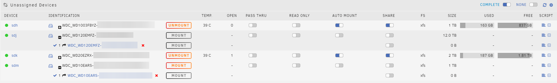

Thanks. I tried and the following is the output (seems not working with the 2nd command😞
root@UnRaid:~# wipefs -a /dev/ sdj1
wipefs: error: /dev/: probing initialization failed: Is a directory
root@UnRaid:~# wipefs -a /dev/sdm1
/dev/sdm1: 4 bytes were erased at offset 0x00000000 (xfs): 58 46 53 42
root@UnRaid:~# wipefs -a /dev/sdj
/dev/sdj: 2 bytes were erased at offset 0x000001fe (dos): 55 aa
/dev/sdj: calling ioctl to re-read partition table: Device or resource busy
/dev/sdm: 2 bytes were erased at offset 0x000001fe (dos): 55 aa
/dev/sdm: calling ioctl to re-read partition table: Device or resource busy
root@UnRaid:~#
Now, both of them are not mountable (with greyed mount button) in Unassigned Devices.
Edited by PzrrL
Add one more line at the end
sdj1 wasn't successful, so you shouldn't have run sdj, though it won't matter much, reboot and try running preclear again.
Thanks! After another rebooting, they shown as mountable, and I am able to preclear them now. Thank you so much!
