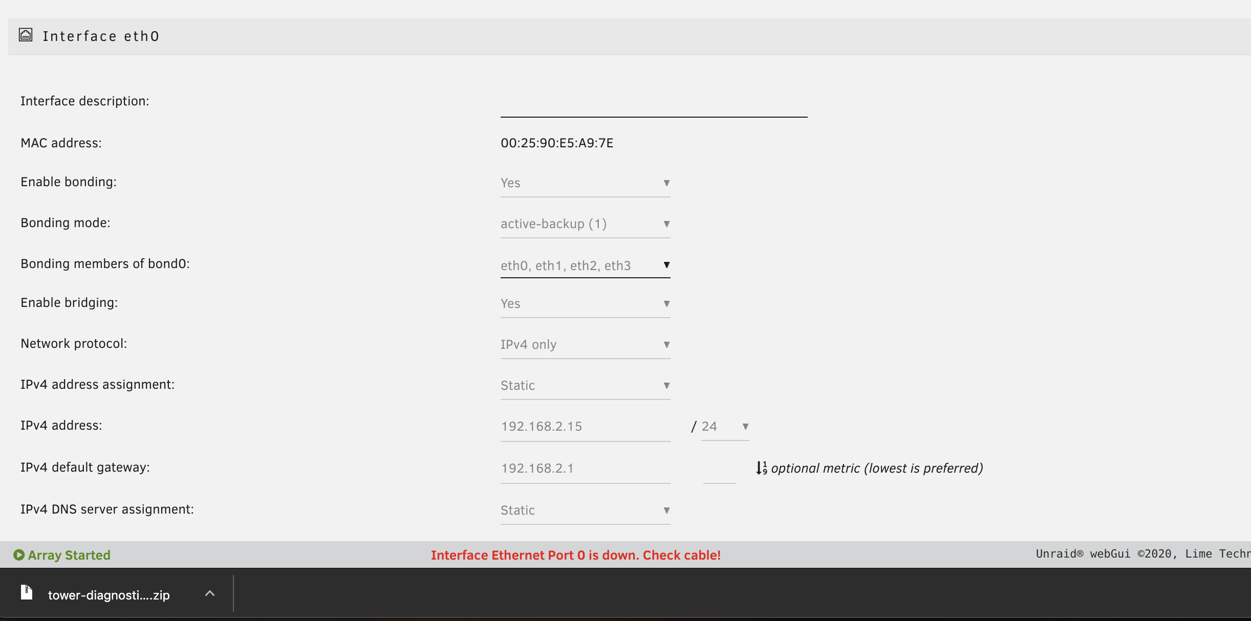

Hello all,
How a power outage due to the tropical storm the other day. I had a UPS on the server, however I am not sure if it did shut down gracefully or not? I booted it up last night, and it appears to have some networking issues? It becomes unresponsive on my local network pretty frequently. Any session I have with it via browser, it drops. Any authentication I have with it, it logs me off.
Any help would be greatly appreciated.
1949846215_ScreenShot2020-08-06at8_47_56AM.thumb.png.444ef9a030219dbf13a681669fe026d5.png

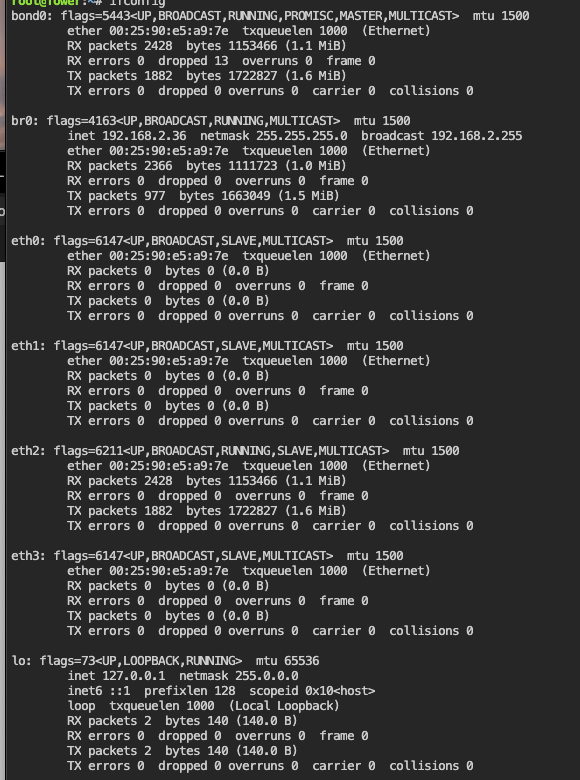

running ifconfig:
1462378055_ScreenShot2020-08-06at5_21_50PM.thumb.png.d2eb0232e088a295722b0d87aa7a75d7.png
Could this be the culprit? I have a few VM's running on it, and it looks like br0 is the one with the IP addr.
I plugged in several ethernet cables, I have multiple ethernet adapters. With 2 cables plugged in, eth0 never propagates. I see eth1, and br0..
Spent more time on it, not sure what else it could be. Is there anything else anyone would suggest? Thinking about doing a fresh install and see if that helps.
