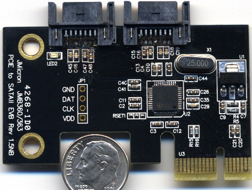

Can someone provide a HiRes pictures of the both sides to identify the ROM.
In theory someone can purchase an equivalent flash chip and get it done - on the Ebay's picture there is a big juicy place for header (GND, DATA, CLOCK and VDD)  ;)
Hope this helps. If you can find a flash chip, you have better eyes than I. Also scanned at 1600 dpi but the file is 21M.  The back has a few more capacitors and resistors but that is it. From the 1600 dpi scan I was able to confirm it is in fact a JMB362 chip. I believe the ROM is built into the JMB362.

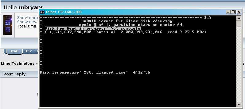

Ordered 2 and finally got around to adding one to the PCIe x1 slot.  Pre-clearing a new Samsung HD204UI - progressing normally.
Apr 11 20:18:11 Tower pspci[4602]: 02:00.0 SATA controller: JMicron Technologies, Inc. Unknown device 2362 (rev 10)
