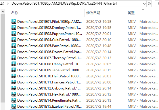

August 7, 20206 yr Hi all, I installed the plex from Apps tab, and configure to pick up my movies and tv shows, on a plex client i can see all my folders, however i could only see show files, majority of the tv show (*.mkv files) are missing, i dont recall seeing this when i use a plex server with my old synology NAS. does plex on docker has some limitation on what media format it suppors? (e.g. audio or video coding type etc.) has anyone experienced similar thing before? thanks advance.

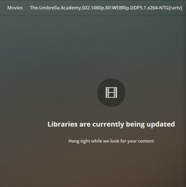

August 7, 20206 yr Plex has to build your library, as it's telling you so in your first image. So... wait until it's finished. Edited August 7, 20206 yr by Energen
August 7, 20206 yr Author 8 hours ago, Energen said: Plex has to build your library, as it's telling you so in your first image. So... wait until it's finished. once it finish, it says "There are no item in this folder"
August 7, 20206 yr In that case, something is probably wrong with your configuration. You'd have to check all your file paths in the docker container and in your plex libraries and settings. And make sure your info scrapers are correct. In your image it says Movies and then is season 2 of a TV show... so if you have them set incorrectly it's not going to show you anything because it's scraping the wrong thing.

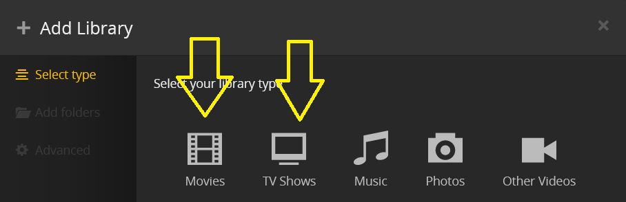

August 7, 20206 yr You might have one share for both but you have to configure your Plex libraries differently for TV and Movies.

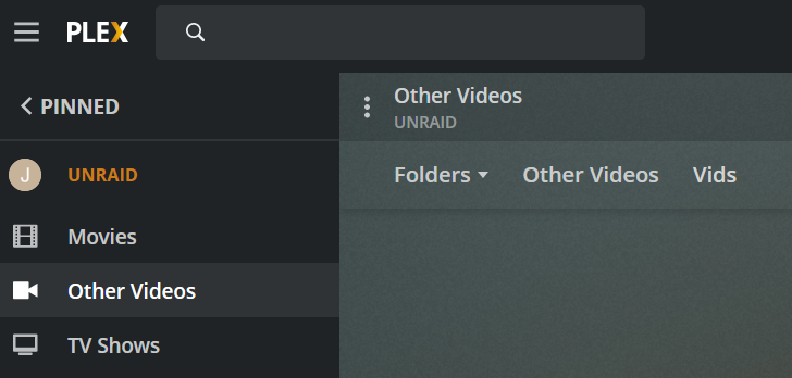

August 8, 20206 yr Author 11 hours ago, Energen said: You might have one share for both but you have to configure your Plex libraries differently for TV and Movies. thank you so much for your help. not idea why "Movies" and "TV Shows" actually make a difference. with your help i use other videos, it actually picked up all my shows and stuff. now will set up the hardware transcoding. thanks again for your help.
August 8, 20206 yr 2 minutes ago, iamsammajor said: thank you so much for your help. not idea why "Movies" and "TV Shows" actually make a difference. with your help i use other videos, it actually picked up all my shows and stuff. That's still not the proper way to set it up. Other Videos uses the Plex Video Files Scanner which is a generic scanner that will/can match a lot of stuff to movies or tv but it won't get everything, and you won't generate much metadata from it (artwork, etc). Plex Video Files Scanner This scanner is similar to the Plex Movie Scanner, but is less strict in how the media files are named. It is meant to match as much content as possible for you, but at the same time it also isn’t as smart as the normal scanner. Some features/limitations: Does not exclude content named like a TV episode Does not support stacked content Internet based information will not be fetched – so no posters etc. If the Local Media Agent is enabled, embedded and other local assets will be used You should use the Movies library for your movies and the TV library for your television. Even if the video file scanner picked up all of your media it would all be contained within the 'other videos' folder and not sorted, nicely, into tv and movies.

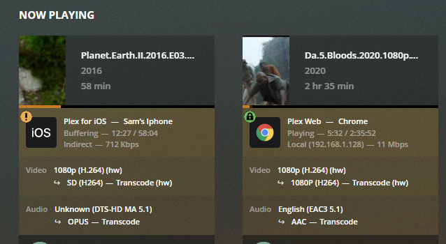

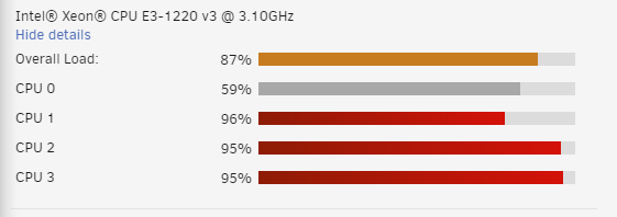

August 8, 20206 yr Author yeah i took you advise to have one for movie and one for TV show, it makes sense. my CPU still ramp up quite a bit when i use watch the movie on my phone. i cant see "HW" tag in audio, does it mean CPU is still doing work for it?
August 8, 20206 yr Yes, both of those streams are transcoding on the fly, meaning they are using the CPU to convert the media for playback. By the looks of it your P400 is not being used for transcoding.. if you intend on using that you'll have to learn about passing the gpu through to the plex docker and stuff like that.
