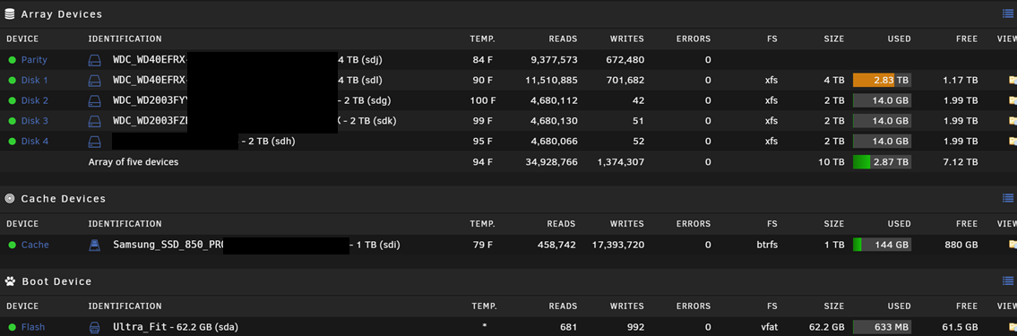

New to Unraid....so bear with me. I have been moving my data onto my server. All has been fine, but this morning I woke up an noticed this error
I thought that Unraid managed all of the data across the various drives I have installed automatically that I have set up?
Is this an FYI warning or something worse?
Did I misconfigure my array somehow? See my other screenshots for my disk config screenshots.
Just not sure if I am set up properly or I am heading to a bad place or not.
Thanks!
No, it is based on share settings.
In each share configuration, you can set up the allocation method and the split level.  Turn on Help on the share settings page to see a description of how each setting works.
In addition to the allocation method, you can limit which disk(s) are used by either including or excluding (both are not needed) disks from a share.
There is lots of flexibility, but, you also have to understand how it works and what the results will be.
I don't have access to my system at the moment to take any screen shots, but, here is a link to some documentation on the subject.

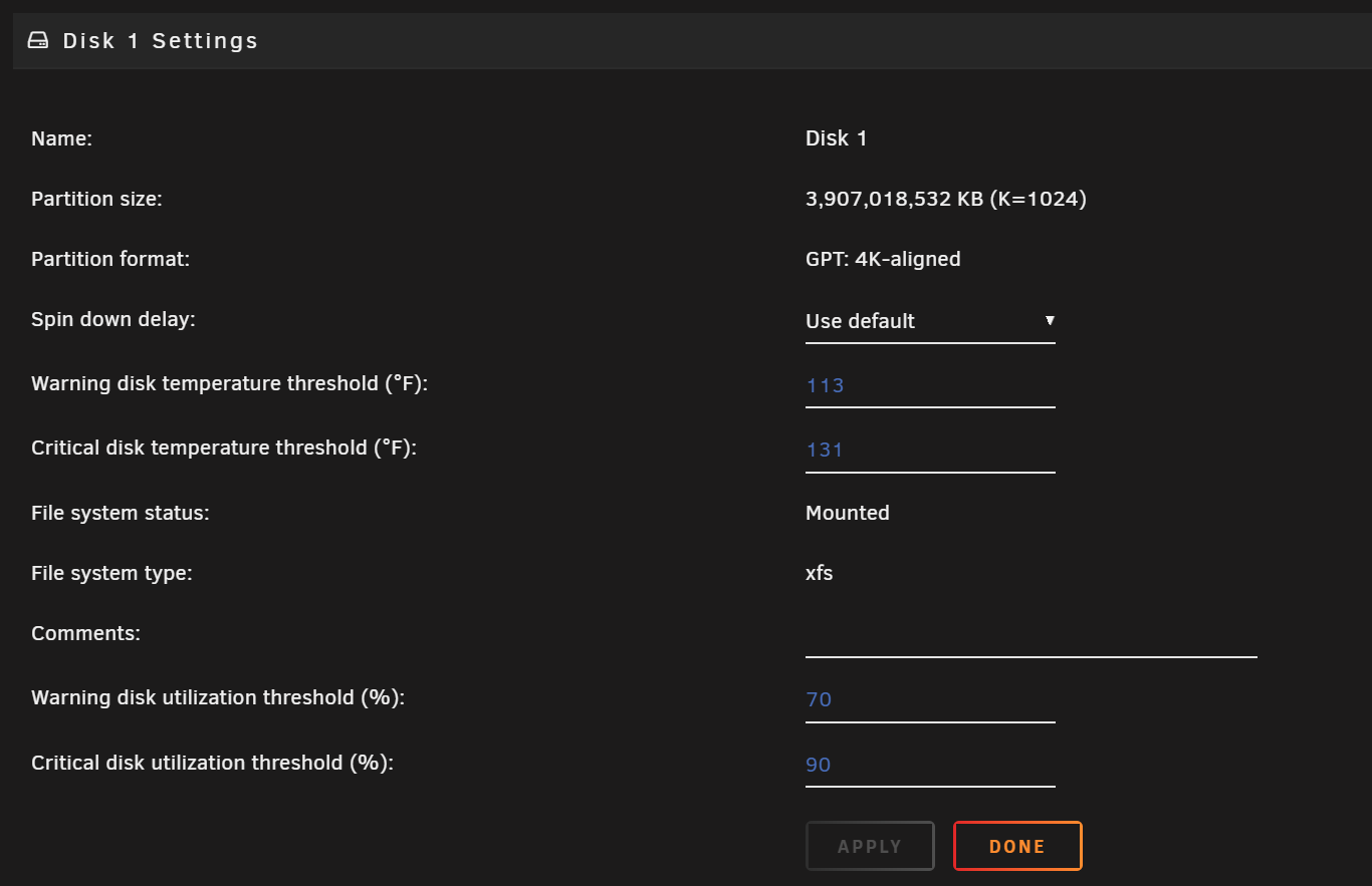

Assuming user shares have default Allocation Method of Highwater, what you have is normal. You can adjust the warning level for each disk as seen in that 2nd screenshot you posted.
Disk1 has 4TB free, so disk1 is chosen first, and Highwater is set at half the remaining capacity of the disk, 2TB free. So it uses disk1 until it has 2TB free.
Then it re-evaluates Highwater.
Now disk1 has 2TB free, and all other disks also have 2TB free, so disk1 is chosen first, and Highwater is set at half the remaining, 1TB free. It will continue to use disk1 until it has 1TB free, then go on to disk2 until it has 1TB free, and so on.
Other allocation methods are available, but Highwater is default for good reasons. It is a compromise between using all disks (eventually) without constantly switching disks, as would happen with Most Free Allocation.
