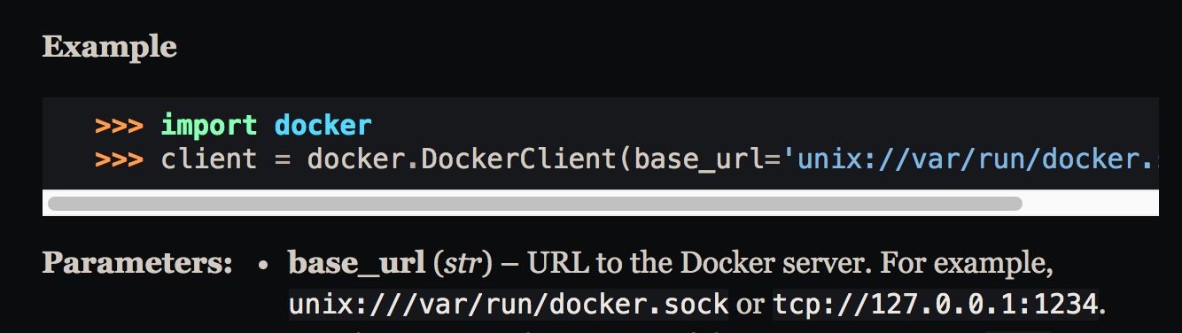

August 6, 20206 yr Author I'd like to try using the python docker library to access the UnRAID server's docker API. I can't figure out what endpoint to give it. What port number do I use in the format tcp://<ip>:<port>

August 8, 20206 yr Author I found a different workaround. Rather than trying to enable the HTTP REST API by changing the dockerd statup option, I decided to use the built-in feature of the docker client to use the ssh protocol to access a remote docker server. This requires that you've already setup public/private key ssh access to your UnRAID server (details here) Once that is working, I can just run this from my client: $docker -H ssh://root@tower:22 ps CONTAINER ID IMAGE COMMAND CREATED STATUS PORTS blahh blah Edited August 8, 20206 yr by frakman1
October 5, 20224 yr a bit of a necro-post, but I was having a play around with this earlier, and to get it working you just need to put DOCKER_OPTS="-H tcp://0.0.0.0:2376 -H unix:///var/run/docker.sock" into /boot/config/docker.cfg of course, you then get the warning... Quote WARNING: API is accessible on http://0.0.0.0:2376 without encryption. Access to the remote API is equivalent to root access on the host. Refer to the 'Docker daemon attack surface' section in the documentation for more information: https://docs.docker.com/go/attack-surface/ And the Docker Start Stop page in the UI cracks the whoops a bit as well.... I'm actually now moving onto using a dockersocket proxy container instead (tecnativa/docker-socket-proxy) Edited October 5, 20224 yr by Meles Meles
