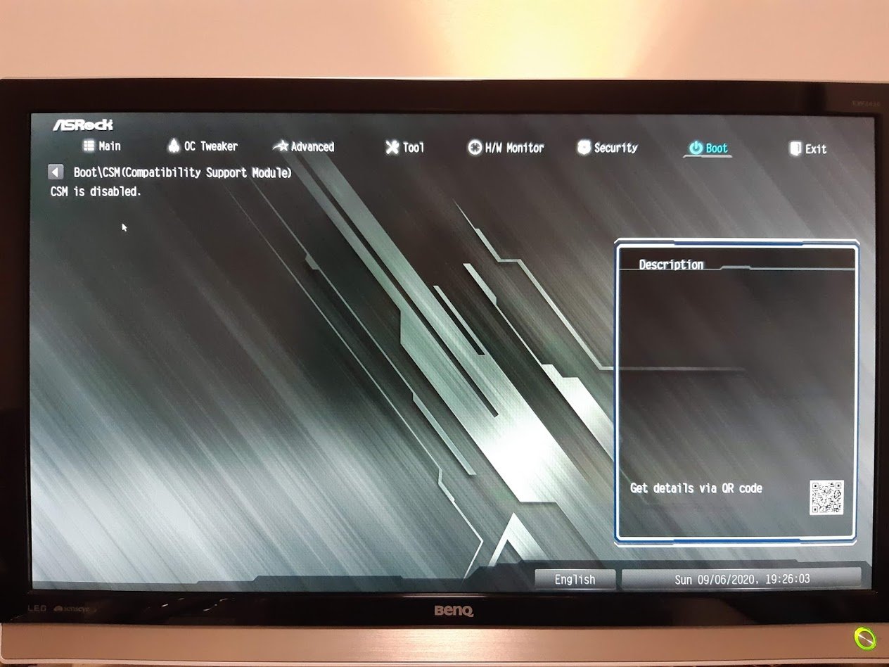

September 8, 20205 yr Hi guys, I do not want to start a new thread if my problem is the same, but requires different solution. I am new in Unraid and using trial still. I got a problem booting in GUI mode too on UEFI. Unfortunately CSM mode is disabled on MB. My config is - Asrock x570m pro4 - Ryzen 5 pro 3400ge - 2x16Gb Kingston DDR4 2666 ECC Udimm Are there still options how to boot in UEFI with GUI? I read about "nomodeset" in config @USB stick, but I am not sure about right syntaxis. Thanks in advance

September 11, 20205 yr 22 hours ago, joshkrz said: That's strange that you have no options in that menu, check the other tabs to see if you have a global CSM switch. You could also try using the latest Unraid Beta. I can boot using v6.9 Beta 25 with CSM disabled. There is no other tab in Asrock's BIOS. I'm on 6.9 b25, but it does not load with GUI on my. Probably it's because you and I have different graphic chips. So, on integrated Radeon GUI does not work with UEFI + no CSM. I am lucky that Asrock support is quick in responses and I have been told that due to AMD Renoir APUs will not have CSM enabled. Now Asrock cleared that out between different APU/CPUs and I received new BIOS 3.01 for Asrock x570m pro4 per email. Now I can switch on CSM. But the problem remains: Unraid does not show GUI without CSM enabled in UEFI mode for at least Picasso APUs. How can I claim it to developers? I'll try at least.
September 23, 20205 yr I have requested Lime Tech support and at the end of the day it's said that they "cannot promise to make something work on specific hardware". As I understand, all AMD APUs with integrated Radeon graphics is not supported by GUI mode. Probably the AMD APU based NAS market is too small for Lime Tech to look at this issue. For me it would be sufficient if the company indicates that AMD APUs are out of range of the GUI features.

September 23, 20205 yr Unraid boots both in normal and GUI mode. In the GUI mode display shows the loading process until the moment, when the login page must appear. Then the screen becomes blank with the blinking underscore in the left top corner. I need GUI mode to manage Unraid locally. CSM is not supported by new Renoir APUs. This is what Asrock has written me on my support request about disabled CSM.
