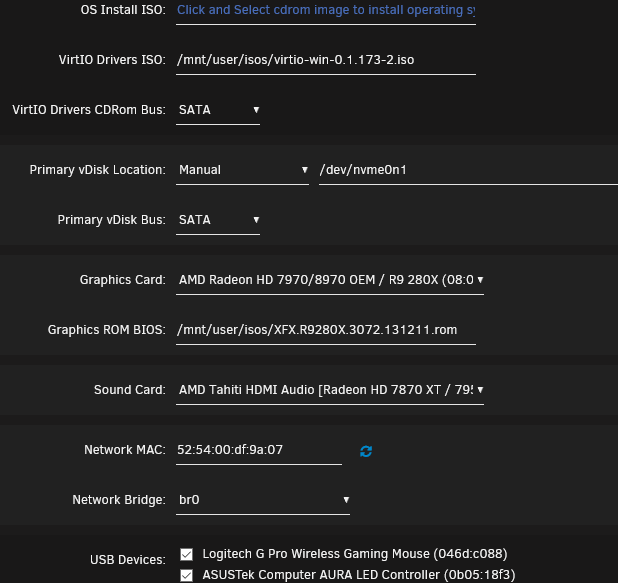

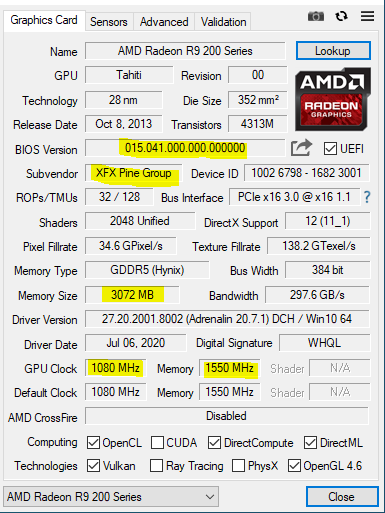

August 9, 20206 yr Hi there, I am new here and overall in unraid, so I am actually in the trial period and since almost two days I am confronted with a GPU passthrough problem. My system: Ryzen 9 3900X 64GB (non-ECC) RAM ASUS TUF Gaming x570 plus Motherboard Radeon 280X 3GB 512 nvme and a few old harddisks and ssd´s My goal is to Game almost "nativ" via unraid system. So the final status should be, I am starting the workstation and booting into unraid. Win10 (Virtual Client) starts automatically and I can play games, etc. etc. and also reach my unraid Interface to manage it from the Virtual Client (as far as the VM doesnt need to be restarted =)) I ve already installed a full working Windows 10 on my nvme (512GB) and i pass it trough (that works with VNC graphics), but when I try to passthrough my AMD Graphicscard I get some problems :-( My Graphics card (Gpu-Z): https://www.techpowerup.com/gpu-specs/xfx-double-d-r9-280x-black-edition.b2671 Here are my VM settings: Logs are showing following errors: ErrorWarningSystemArrayLogin 2020-08-09T17:57:01.748539Z qemu-system-x86_64: vfio_region_write(0000:08:00.0:region0+0xf3554a0, 0x0,8) failed: Device or resource busy 2020-08-09T17:57:01.748547Z qemu-system-x86_64: vfio_region_write(0000:08:00.0:region0+0xf3554a8, 0x0,8) failed: Device or resource busy 2020-08-09T17:57:01.748555Z qemu-system-x86_64: vfio_region_write(0000:08:00.0:region0+0xf3554b0, 0x0,8) failed: Device or resource busy 2020-08-09T17:57:01.748563Z qemu-system-x86_64: vfio_region_write(0000:08:00.0:region0+0xf3554b8, 0x0,8) failed: Device or resource busy 2020-08-09T17:57:01.748571Z qemu-system-x86_64: vfio_region_write(0000:08:00.0:region0+0xf3554c0, 0x0,8) failed: Device or resource busy 2020-08-09T17:57:01.748578Z qemu-system-x86_64: vfio_region_write(0000:08:00.0:region0+0xf3554c8, 0x0,8) failed: Device or resource busy 2020-08-09T17:57:01.748587Z qemu-system-x86_64: vfio_region_write(0000:08:00.0:region0+0xf3554d0, 0x0,8) failed: Device or resource busy 2020-08-09T17:57:01.748594Z qemu-system-x86_64: vfio_region_write(0000:08:00.0:region0+0xf3554d8, 0x0,8) failed: Device or resource busy 2020-08-09T17:57:01.748602Z qemu-system-x86_64: vfio_region_write(0000:08:00.0:region0+0xf3554e0, 0x0,8) failed: Device or resource busy 2020-08-09T17:57:01.748609Z qemu-system-x86_64: vfio_region_write(0000:08:00.0:region0+0xf3554e8, 0x0,8) failed: Device or resource busy 2020-08-09T17:57:01.748618Z qemu-system-x86_64: vfio_region_write(0000:08:00.0:region0+0xf3554f0, 0x0,8) failed: Device or resource busy VGA and Graphicsound seems to be in the same IOMMU Group. Hopefully there is someone who can help me with this issue :'-( Thanks in advance. Kind Regards, Reini

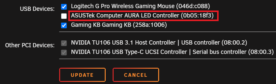

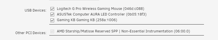

November 17, 20205 yr Author @mikotoiii thx for your reply and sorry for my late reply, yes I solved it with a newer version of unraid (at the moment I am on beta 35, but it worked already with version 30) thank you! But to be honest, I am not sure if I will stay with Unraid, my system freezes every day 3-4 times, I think it´s an Issue with the soundsystem (connected as mentioned via TOSLINK) or maybe its according to Spotify - I´ve no idea... Interessing fact, If I switch the audio Input to my headset (connected to the fron panel AUX conection) and starting CS GO (Counter Strike) for a game and playing a song in spotify, there´s no Issue, so I guess its something wrong with the connected Logitech Soundsystem to the TOSLINK 😞 On and on it helps to Pause the VM and Resume it again, but not always. Btw. another Issue - I had sooo many USB Problems caused by the following Passthrough: Since I´ve disbaled the "ASUSTek Computer AURA LED Controller" I´ve less Issues... just 4 info, if someone using a ASUS TUF Gaming x570 PLUS as I do...
