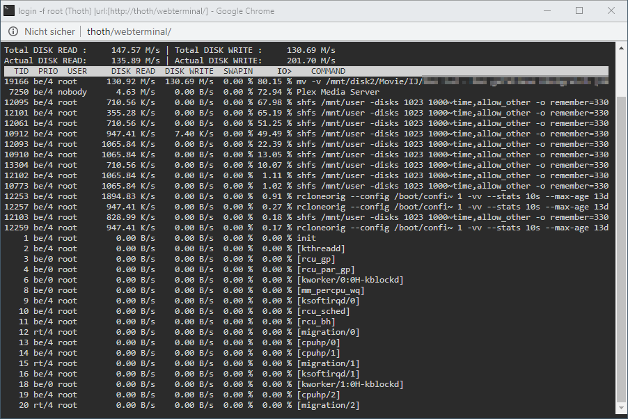

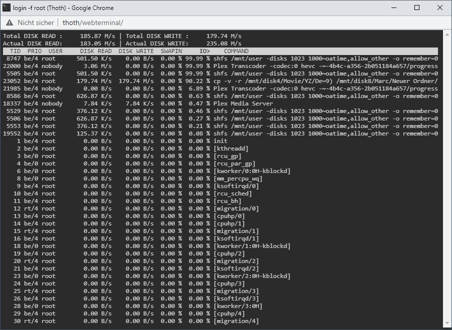

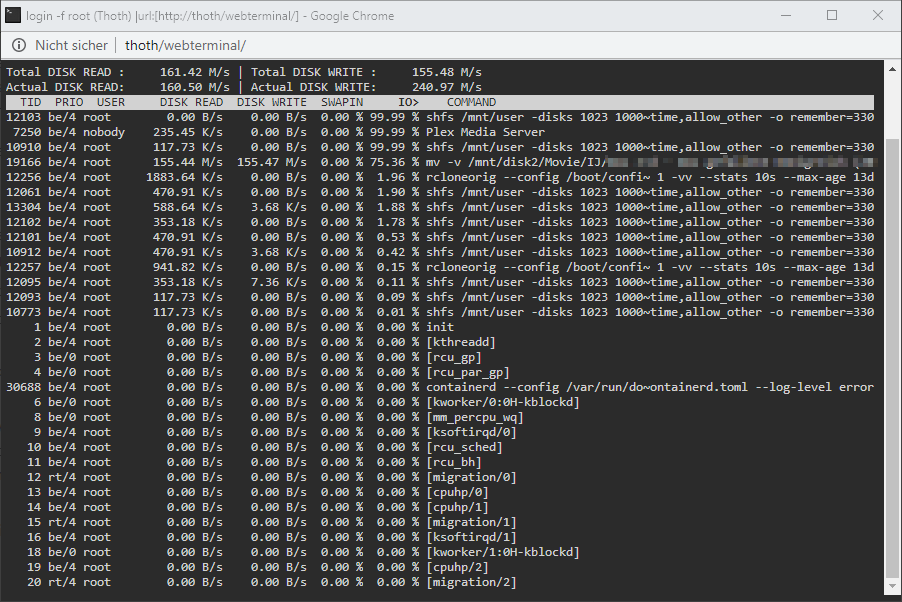

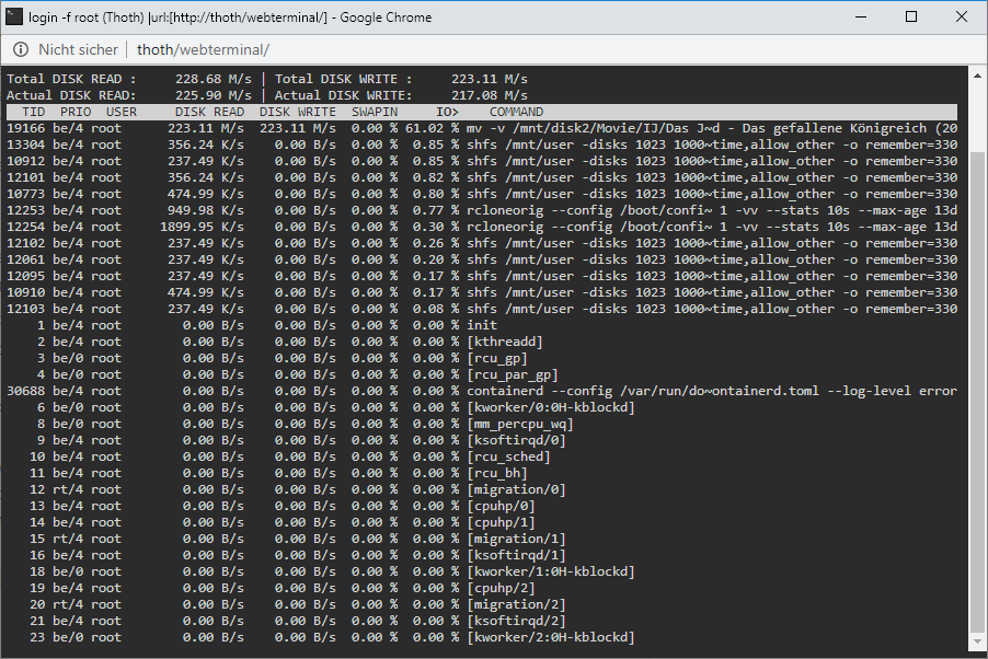

August 9, 20206 yr I'm moving some movie files from disk2 to disk3 with the following command: mv -v "/mnt/disk2/Movie/IJ/"* /mnt/disk3/Movie/IJ At the same moment I'm watching a movie through Plex from disk2 and its stuttering. iotop returns the following: If I pause the movie the IO load of "mv" falls to around 60%: If I resume the movie multiple SHFS processes kick in and produce a massive load so everything raises up (up to 99.99%, see first screenshot): Why are there so many of them producing so much IO load? I mean its only a movie with a bitrate of around 40 Mbit/s (5 MB/s) and it should be an easy task for a 7200 rpm HDD to have one file transfer and one movie stream at the same time. Server specs Supermicro A2SDi-8C+-HLN4F Intel Atom C3758 (4675 cpubenchmark points) 32 GB RAM 10x Western Digital Ultrastar DC HC520 12TB XFS formatted Sorry I can not provide the full diagnostics as altough unraid states, that they are anonymized, they contain file names that are private. So please ask for specific log files and I will censor them manually, before posting them. Edited August 9, 20206 yr by mgutt

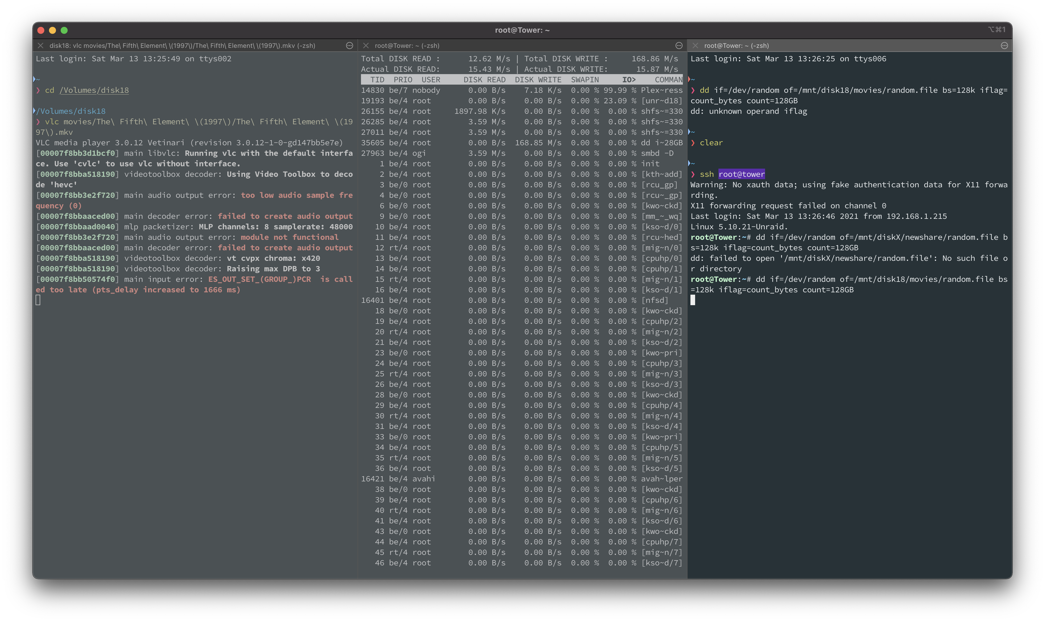

March 13, 20215 yr It's running now; I'm getting occasional hangups in the stream; here is a screenshot when during one of those freezes... for the most part its playing well. The `dd` command finished root@Tower:~# dd if=/dev/random of=/mnt/disk18/movies/random.file bs=128k iflag=count_bytes count=128GB 976562+1 records in 976562+1 records out 128000000000 bytes (128 GB, 119 GiB) copied, 2241.48 s, 57.1 MB/s root@Tower:~# Given the movie (mostly) played w/o interruption, not sure what to make of it. Edited March 13, 20215 yr by ogi moreinformation
March 13, 20215 yr Author Now repeat the test, but replace /mnt/disk18/movies against /mnt/user/movies in the dd command.
