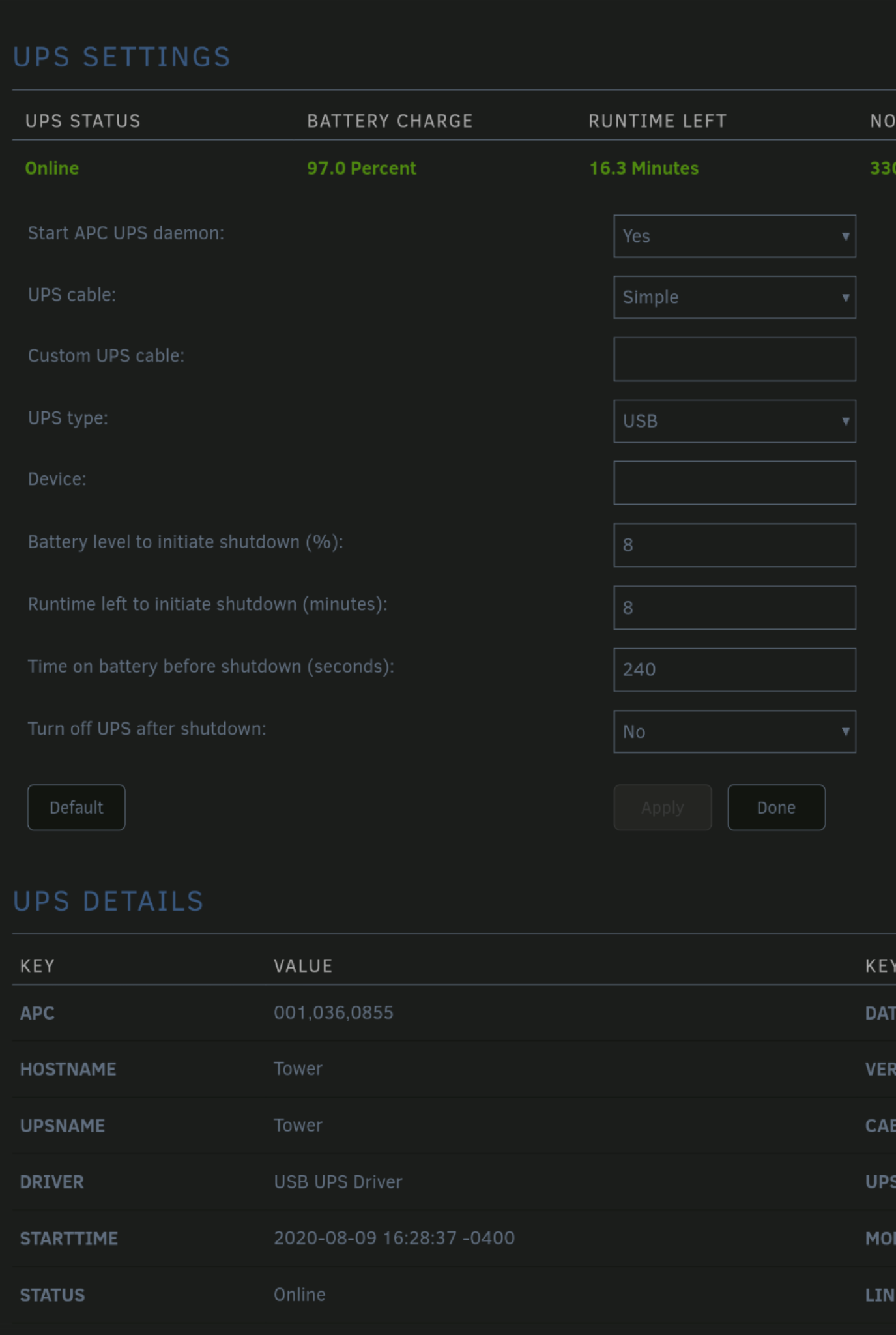

August 10, 20206 yr I've had a couple power issue recently and I've not received any UPS Alerts, I've got email and Pushbullet set up and tested to be working. Is there anything I might be missing? In order to receive an alert when the server goes on Battery. Edited August 10, 20206 yr by Fiservedpi

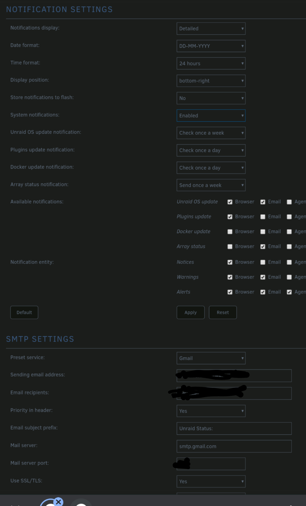

August 10, 20206 yr Community Expert I would assume that you have tested the E-mail setup to make sure everything is properly configured and that you do receive the test message. (I had to config G-mail to work with the Unraid smtp system) If that is all good, then setup the Syslog Server. (I would use the Mirror syslog to flash: option) See here: https://forums.unraid.net/topic/46802-faq-for-unraid-v6/page/2/?tab=comments#comment-781601 Disconnect the power and let the server shutdown. Pull the flash drive, copy the syslog off the flash drive and see what it says about the e-mail transmission.
August 10, 20206 yr Author Yep all "test" notifications work properly just not when it really counts! Lol, ok I'll try out the mirror syslog option to see what's going on thank you

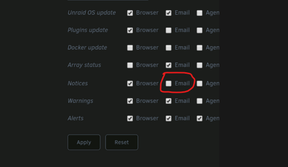

August 10, 20206 yr Community Expert I had a second look at your original post. I would suggest that you enable this one In the Notifications menu:
