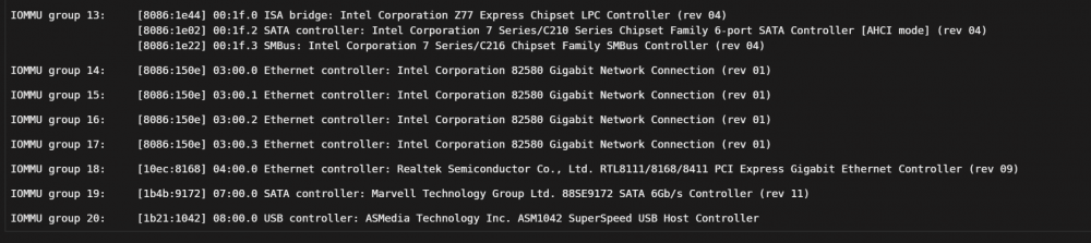

I had a working setup with a 4 port intel network card and pfsense running in a VM (following Spaceinvader guide mostly).  Then I had a disk fail and some issues, that i've fixed.

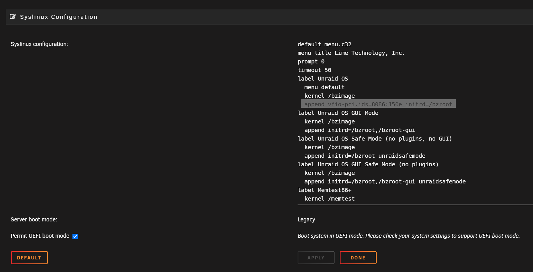

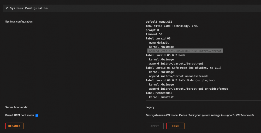

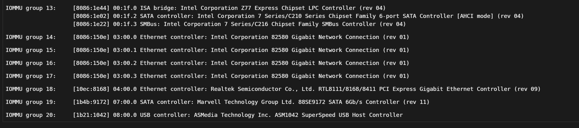

Now my last issue is I can't get my pfsense working again.  It seems that unRaid keeps detecting and initializing my 4 port NIC even thought I have used the "append vfio-pci.ids=8086:150e initrd=/bzroot" in my syslinux config.  This used to work fine, but now unRaid just keeps detecting the card and I can't pass it thru to the VM.  Any suggestion? I've tried deleting the vfio-pci.ids=8086:150e line and rebooting, but adding it back it still doesn't work.

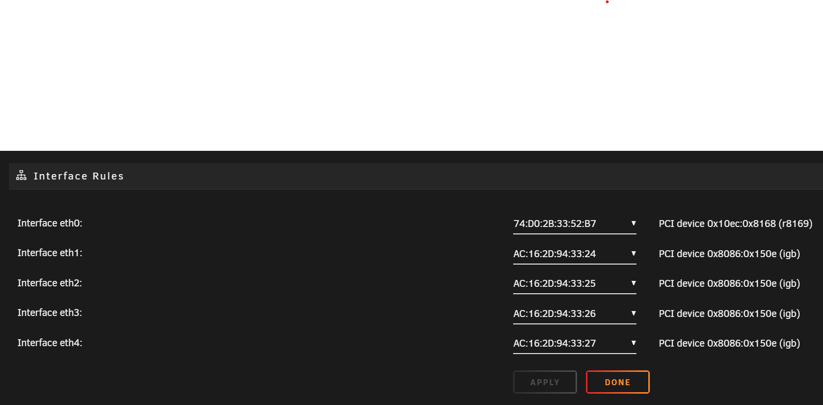

Thanks.  I tried the plug-in using v6.7.3 and I ran into the same issue that @Keexrean had where two ports were being passed, but two were remaining in Unraid.  Unraid was also randomly reassigning the eth0 interface to the HW address of the wrong Ethernet port after reboots.
I then uninstalled the plugin, installed v6.9.0 Beta 25.  I used the now built in tool to select the 4 ethernet ports off the NIC.  That was the solution as it is now working again.  I'm back to just having append  initrd=/bzroot in my syslinux config.
