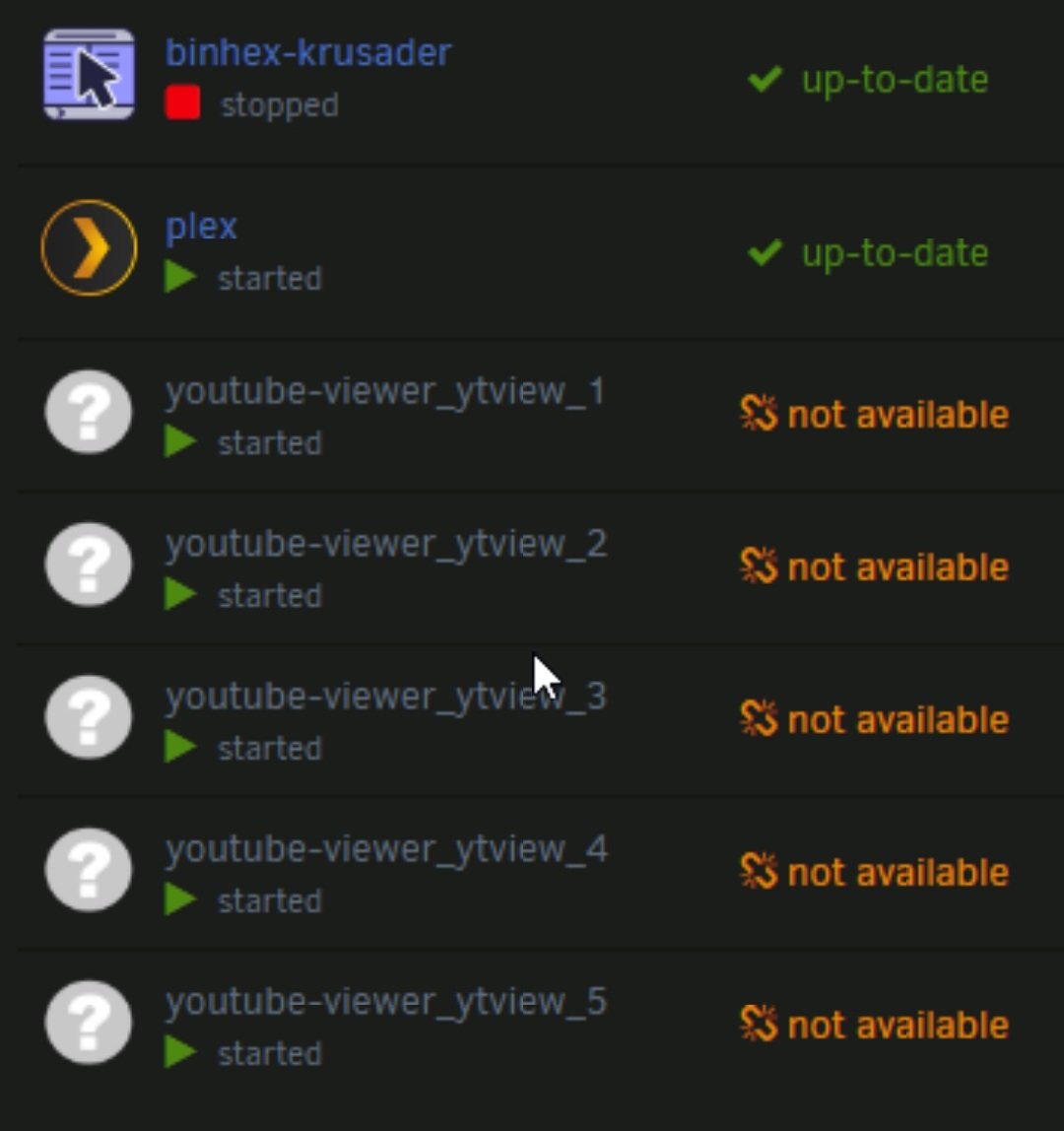

Just logged into my server and checked out the docker tab. I should only have Krusader and Plex, but I see all these youtube-viewer dockers.
I did a search for that and found nothing.
Anyone have a clue what these are?

It was. Not anymore. I nuked all those dockers, changed my passwords, and closed all open ports (there were only two, one for management and one to Plex - which I'm told Plex should work without that port open).

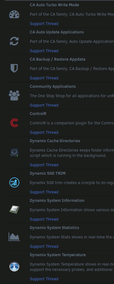

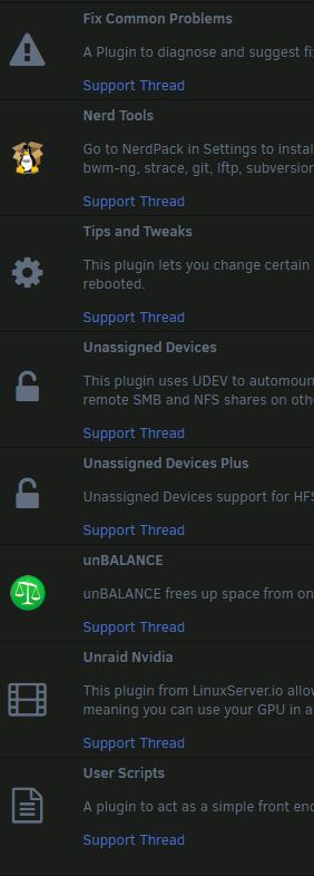

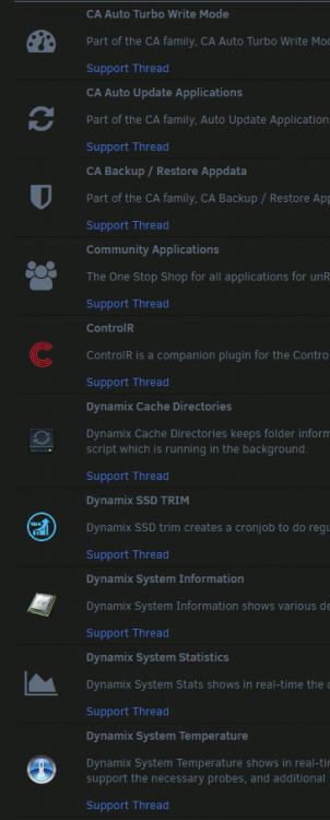

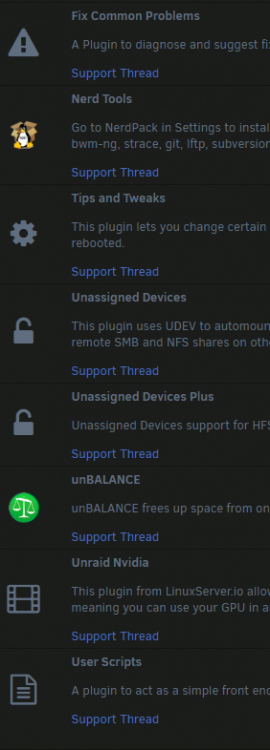

I have a handful of plugins. All fairly common/prevalent among unRAID users, I think.
