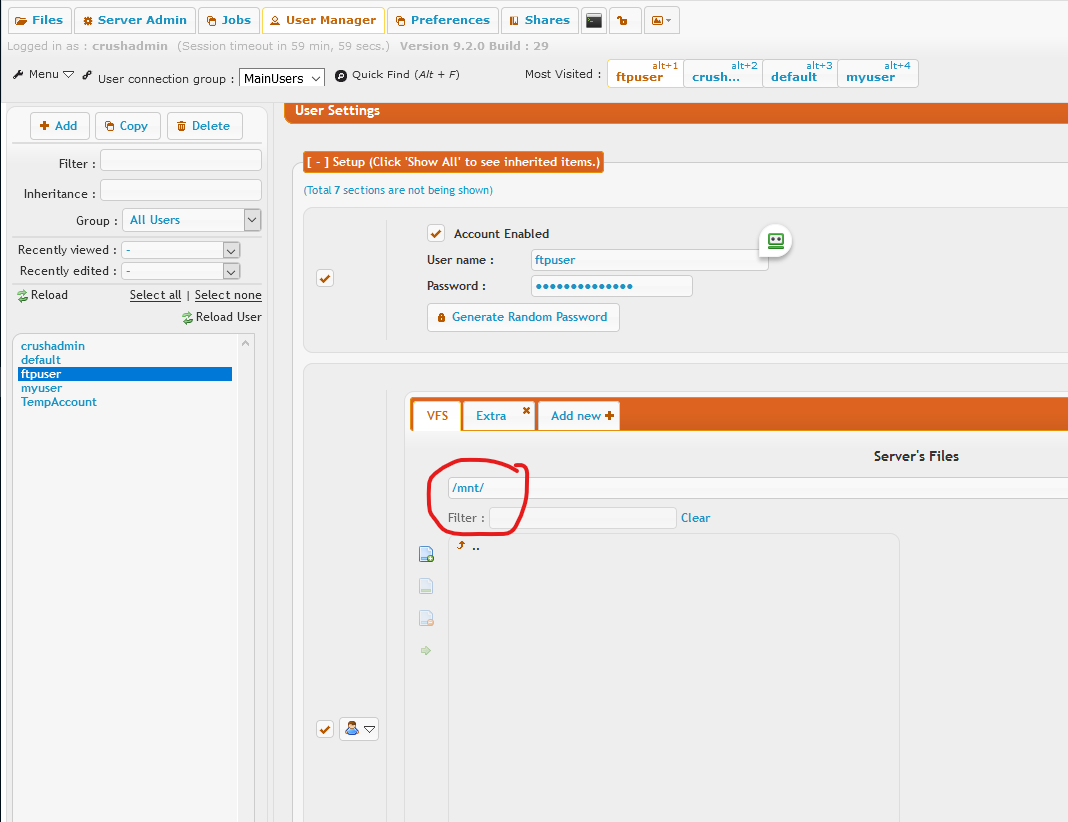

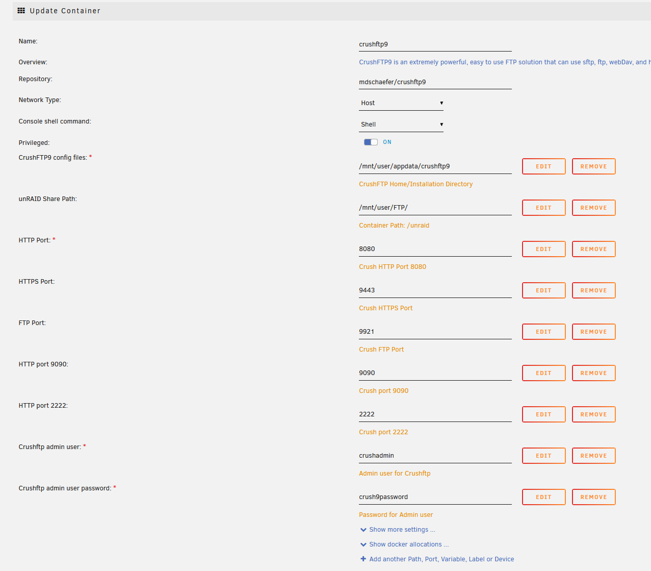

Hi, I just installed crushftp9 docker. I can access the Webgui, but for some reason when i try to set the base FTP folder for a user to a share a created as FTP i dont see it under the /mnt/user/FTP. As you can see form the screenshot it does not exits? Any idea why this happening please?

From your screenshot, /mnt/user/FTP at the Unraid host level will show up as /unraid  inside the Docker.   Have you allowed for that?
This was it. Thank you!!
