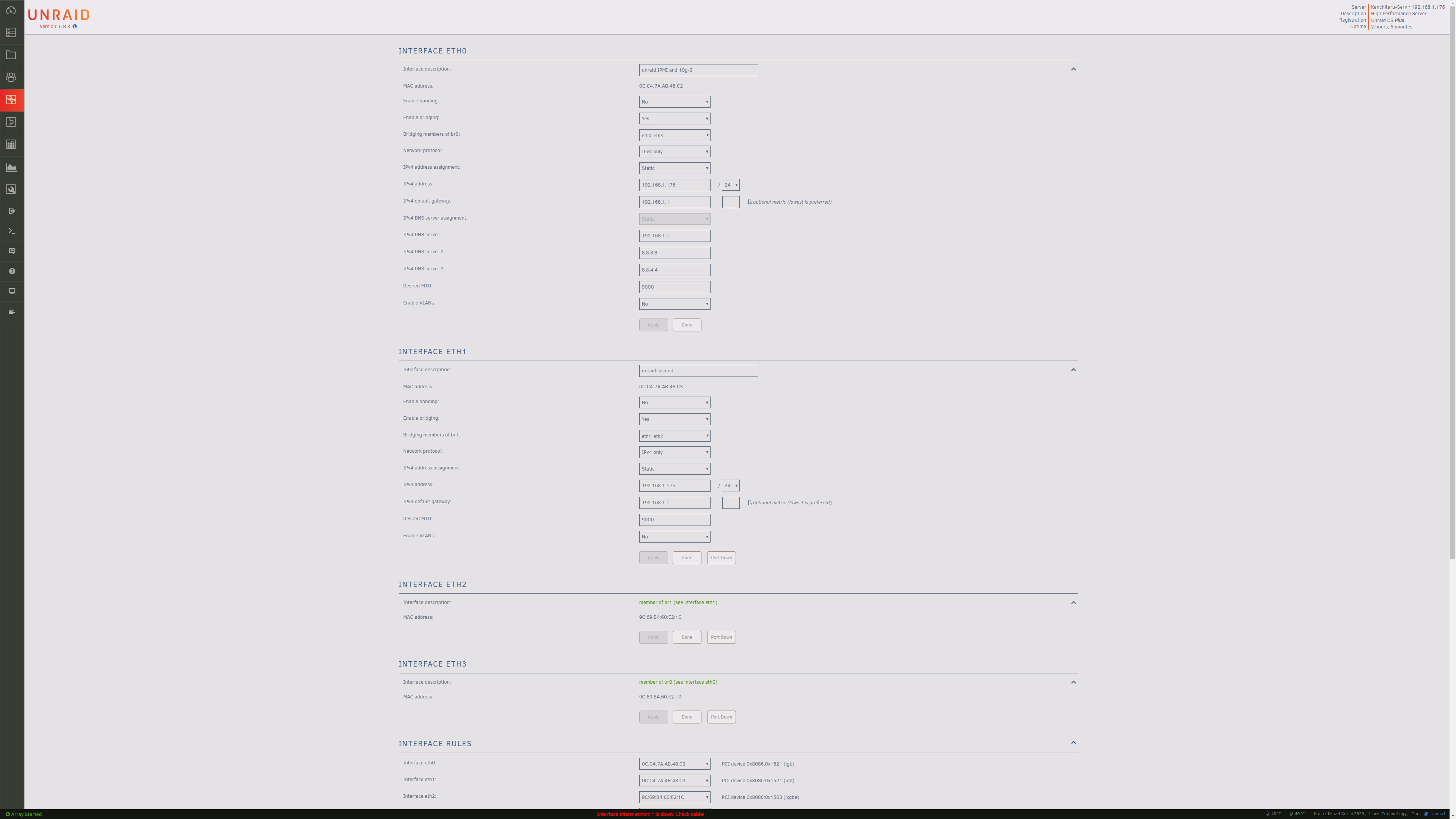

I have an Intel x550 T-2 card in my unraid server for direct 10gbe connectivity to two external computers. One of the ports works perfectly fine getting around 9gbe, while the other port stays fixed at 1gbe. This port shows up as having a 10gbe link and everything though. Initially I thought it could have been a bridging issue:
My network setup (for convenience) is to bridge eth2 (10g) to eth0(1g to internet) and eth3(10g) to eth1(1g also to internet). (in the screenshot they are inverted because I was testing it out)
This results in eth3 achieving 10g but eth2 only getting 1g.
I also tried inverting the bridges but eth2 does not go beyond 1g.
I then tried direct connection between server and client and eth2 can do 10g without any issues.
Is there some sort of bridging limitation? I also tried bridging just one of the 10g connections to eth0. Eth3 can do 10g but again eth2 in the same situation gets stuck at 1g...
(Both show up with the exact same settings in ethtool)

Okay so ummm
Apparently Unraid cannot do two 10gbe bridges on the same subnet! If you have two IPs to the server, they need to be clearly separate. I am not sure if this is a bug or a limitation.

eth3 was down during diagnostics saving because it was disconnected...
I have two 1gbe interfaces linked to the router, giving unraid two separate IPs (br0 and br1) and I have two client PCs with 10gbe connectivity connected to the unraid server directly (no 10gbe switch). Unraid bridges the 10gbe connections to the LAN, with each 10gbe network having their own dedicated 1gbe link to the router.
The issue in doing this was that only one of the client links would get full 10gbe speed to unraid, while the other would be set to 1gbe only, even if everything is reporting it as 10gbe. Bridging both 10gbe links to a single 1gbe link also does not allow both client links to achieve 10gbe.
But I managed to get it to work by setting one of the unraid 1gbe links to the router to be on a different subnet. It only works if the interfaces connecting to the router from unraid are on different subnets entirely.
