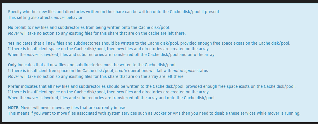

im actually in the process of doing this now. i set the shares to cache only but they're staying on the array. any suggestions on getting them on the new cache drives?
for system i was able to just remake the docker file, but im not sure how to get my appdata on the cache now.
Cache only tells the mover to take no action with files already on the array.  They will stay there but new appdata files will go to cache.
Here's the help from the Shares screen which explains that:
You want to set the appdata share to Cache Prefer which will move everything from array to cache.  Disable Docker first so there are no open files.  After it has been moved, you can set it back to cache only if that is what you want.
Same with isos and domains share if you have VMs but disable VMs before moving.
