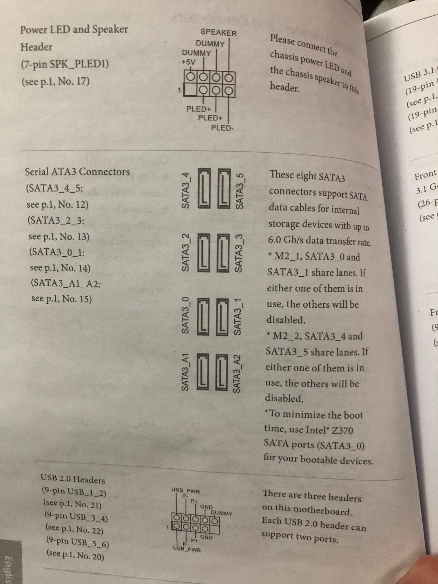

EDIT 8/22/2020: So to update everyone, after doing a motherboard firmware update and changing the cables, I haven't had a shut down in 9 days. Let's hope it keeps going.
Original Post:
I've had my system for a few months now and it seems to lose connectivity to the network about every week or two. When it does, I try to plug in my monitor to the tower but I always get no output. This is weird because when I boot up my tower with the monitor plugged in, it works normally. I figured it was the network port so I just plugged it in a different network port, but the router wouldn't detect it either so I reboot.
I set up logging and copying the logs to my array, and the first 5 or so crashes didn't catch anything. I recently set up Dynamix SSD Trim as well, which was interesting because I got a bunch of errors in my log file. It ran starting at 2 am, and these are the log files attached.
It's strange because functionally, there are no problems with running the system and I'm currently back on my VM via RDP. On the Tower main tab, looks like zero errors logged in each of the drives.
Is there something wrong with my ssd? My setup is 1 parity drive of 6 tb, 2 normal drives of 6 tb, and one 1 tb ssd used for VM and cache.
Also, is it a problem with Dynamix SSD Trim if my VM was running off the SSD while the copy was being initiated?

I have 8 slots and 4 plugs/cables to my board so I have a total of 4 drives connected, one of them being the SSD. I used the 4 slots on the right column in this diagram.
If I switch the plugs, will this screw up my array when I boot it up again? Also, my documentation doesn't show different chipsets.

SATA3_A1 and A2 are the Asmedia ports.

Thank you. If i switch one of the other cables tied to an array drive with the cable for the ssd cache, will it destroy data on either disk?

no
