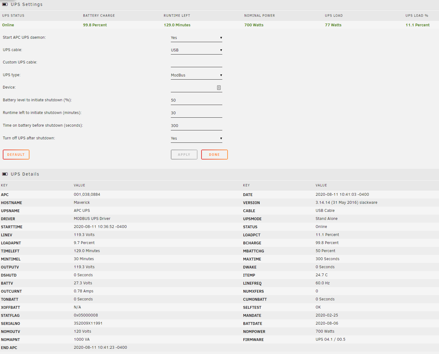

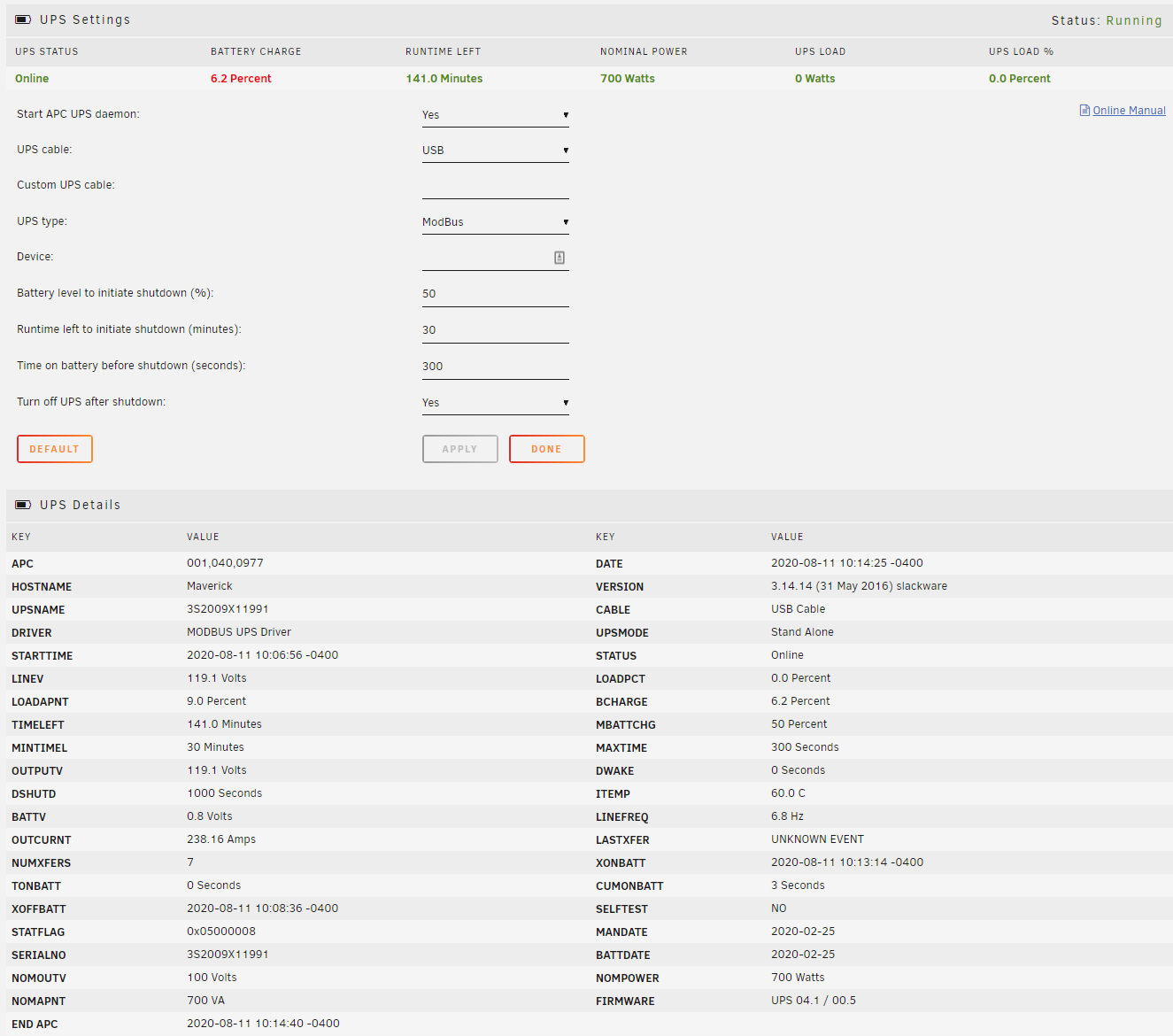

August 11, 20206 yr TL;DR - I can only get apcusbd to work if I both restart apcusbd and unplug and plugin the USB. It doesn't seem to matter which I do first. Having to unplug and plug in a usb each time the server shuts down seems unrealistic. Any help is appreciated. I have a brand new APC P-SMT1000C connected to unraid through USB. When unraid starts up with the USB plugged in from startup, I get the following. It's always some random number for Battery Charge (6.2, 1.5, etc) and it alternates between Online and Online Low Batt. Also the logs reflect power failures. The Aug 11 10:07:19 Maverick apcupsd[4299]: Power failure. Aug 11 10:07:25 Maverick apcupsd[4299]: Power failure. Aug 11 10:08:35 Maverick apcupsd[4299]: Power failure. Aug 11 10:08:36 Maverick apcupsd[4299]: Power is back. UPS running on mains. Aug 11 10:11:10 Maverick webGUI: Successful login user root from 172.17.0.4 Aug 11 10:11:49 Maverick ntpd[2022]: kernel reports TIME_ERROR: 0x41: Clock Unsynchronized Aug 11 10:11:55 Maverick apcupsd[4299]: Power failure. Aug 11 10:12:06 Maverick apcupsd[4299]: Power failure. Aug 11 10:13:17 Maverick apcupsd[4299]: Power failure. Aug 11 10:16:37 Maverick apcupsd[4299]: Power failure. Aug 11 10:16:44 Maverick apcupsd[4299]: Power failure. Aug 11 10:16:52 Maverick apcupsd[4299]: Power failure. Aug 11 10:16:57 Maverick apcupsd[4299]: Power failure. Aug 11 10:17:05 Maverick apcupsd[4299]: Power failure. Then, if I stop the daemon and start it up again, i get the following in the log, with the same battery number percentage: Aug 11 10:24:49 Maverick apcupsd[4299]: apcupsd exiting, signal 15 Aug 11 10:24:49 Maverick kernel: usb 3-2: reset full-speed USB device number 2 using xhci_hcd Aug 11 10:24:49 Maverick apcupsd[4299]: Communications with UPS lost. Aug 11 10:24:49 Maverick apcupsd[4299]: apcupsd shutdown succeeded Aug 11 10:24:49 Maverick kernel: apcupsd[4299]: segfault at 0 ip 000000000041c773 sp 00007ffe4c70b7e0 error 4 in apcupsd[400000+46000] Aug 11 10:24:49 Maverick kernel: Code: 01 40 38 c5 0f 85 1e ff ff ff eb 89 0f 1f 00 80 ce 01 48 89 43 10 be 0c 00 00 00 89 97 08 0d 00 00 e8 e1 93 fe ff 48 8b 7b 18 <48> 8b 07 ff 50 18 e9 60 ff ff ff 66 90 48 89 43 10 48 c7 c0 20 96 Aug 11 10:24:49 Maverick sSMTP[12432]: Creating SSL connection to host Aug 11 10:24:49 Maverick sSMTP[12432]: SSL connection using TLS_AES_256_GCM_SHA384 Aug 11 10:24:52 Maverick sSMTP[12432]: Sent mail for [email protected] (221 2.0.0 closing connection d8sm19737570qtr.12 - gsmtp) uid=0 username=root outbytes=663 Aug 11 10:25:04 Maverick apcupsd[12557]: apcupsd 3.14.14 (31 May 2016) slackware startup succeeded Aug 11 10:25:04 Maverick apcupsd[12557]: NIS server startup succeeded Then unplugging and plugging back in the USB (this works if the daemon has been turned off and back on, but not if i just unplug and plug it in without first restarting the daemon). Aug 11 10:36:02 Maverick kernel: usb 3-2: USB disconnect, device number 2 Aug 11 10:36:03 Maverick apcupsd[4242]: Communications with UPS lost. Aug 11 10:36:03 Maverick sSMTP[14338]: Creating SSL connection to host Aug 11 10:36:03 Maverick sSMTP[14338]: SSL connection using TLS_AES_256_GCM_SHA384 Aug 11 10:36:05 Maverick sSMTP[14338]: Sent mail for [email protected] (221 2.0.0 closing connection j61sm19163637qtd.52 - gsmtp) uid=0 username=root outbytes=659 Aug 11 10:36:08 Maverick kernel: usb 3-2: new full-speed USB device number 3 using xhci_hcd Aug 11 10:36:08 Maverick kernel: hid-generic 0003:051D:0003.0002: hiddev96,hidraw0: USB HID v1.11 Device [American Power Conversion Smart-UPS_1000 FW:UPS 04.1 / ID=1015] on usb-0000:05:00.3-2/input0 Aug 11 10:36:09 Maverick apcupsd[4242]: Communications with UPS restored. Aug 11 10:36:09 Maverick sSMTP[14626]: Creating SSL connection to host Aug 11 10:36:09 Maverick sSMTP[14626]: SSL connection using TLS_AES_256_GCM_SHA384 Aug 11 10:36:11 Maverick sSMTP[14626]: Sent mail for [email protected] (221 2.0.0 closing connection w12sm16316689qkj.116 - gsmtp) uid=0 username=root outbytes=655 Aug 11 10:36:47 Maverick apcupsd[4242]: apcupsd exiting, signal 15 Aug 11 10:36:47 Maverick kernel: usb 3-2: reset full-speed USB device number 3 using xhci_hcd Aug 11 10:36:47 Maverick apcupsd[4242]: apcupsd shutdown succeeded Aug 11 10:36:52 Maverick apcupsd[16707]: apcupsd 3.14.14 (31 May 2016) slackware startup succeeded Aug 11 10:36:52 Maverick apcupsd[16707]: NIS server startup succeeded Here is it working (just to show that it works).

August 11, 20206 yr Author 1 minute ago, Energen said: I'm not home to check mine but you have the UPS type set to ModBus.. I'm not sure if this is correct. ModBus was mainly used for RS232 serial interfaces. I don't know if that's what your problem could be but I would double check your settings first and see if the problems persist. Thank you. The issue is without Modbus, I don't get the real time usage information (I guess not the end of the world, but the missing data bugs me). The device has Modbus settings, which are enabled, and it does work just it doesn't work at startup on its own w/o tinkering. So that tells me it works, but there is something wrong or some setting or something that i'm missing.
