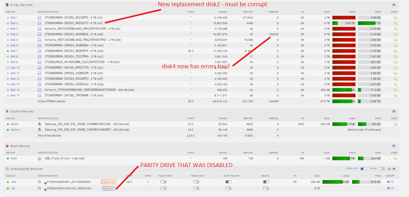

August 12, 20206 yr Hi guys, I've had a really unusual set of circumstances result in what appears like multiple drive failures (but isn't). I've probably lost 2TB of data, I'm at risk of loosing 8TB more and have no partiy now. Please help if you can (diagnostics attached) Order of events: 1. disk2 was disabled by UNRAID for smart errors (7 year old 2TB) 2. Replaced disk2 with new Ironwolf 8TB 3. rebuild failed for some reason and the parity disk was disabled by UNRAID. The parity is a quite new 8TB ironwolf also with no SMART errors to date. 4. I tried to re-seat the cables and reboot just incase something came loose 5. After reboot disk2 appears to be rebuilt which is impossible in the short time it was rebuilding 6. Parity drive is still disabled and stopping the array and trying to remove and re-add it doesn't work, UNRAID doesn't want it. 7. I tried removing disk2 in the GUI because it is obviously corrupt. UNRAID tries putting data on it but the data just vanishes into oblivion. 8. Ran a read check on all drives hoping that UNRAID would see that disk2 is corrupt and let me do something with it but it got 0 errors from disk2 9. disk4 got 120,000 read errors from the test.... another near new ironwolf 8TB with no smart errors which was fine until now. I don't even know where to start with this. I realise that 2TB from disk2 is probably gone. I can live with that I guess. I really don't want to loose another 8TB from disk4. Any help would be received gratefully. nas-diagnostics-20200812-1631.zip

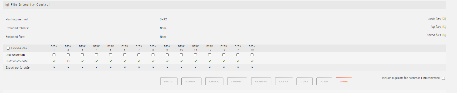

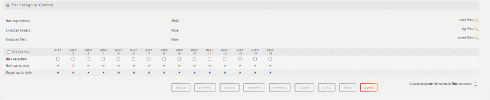

August 13, 20206 yr Author Thanks again Johnnie (sorry I wrote tee-tee earlier, I was on my mobile and mis-read). I attempted another parity sync but it failed and disabled the parity drive again (new diag attached). Re: checksums, I do have Dynamix File Integrity Plugin installed. It runs monthly with SHA2. I have no clue how to use it to help my situation? I've attached a screenshot as it shows that disk2 "build" and "export" are not up to date nas-diagnostics-20200813-1709.zip
