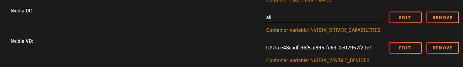

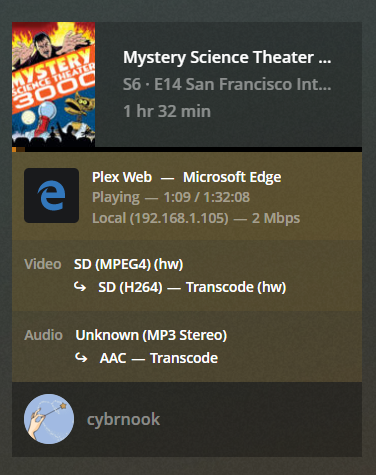

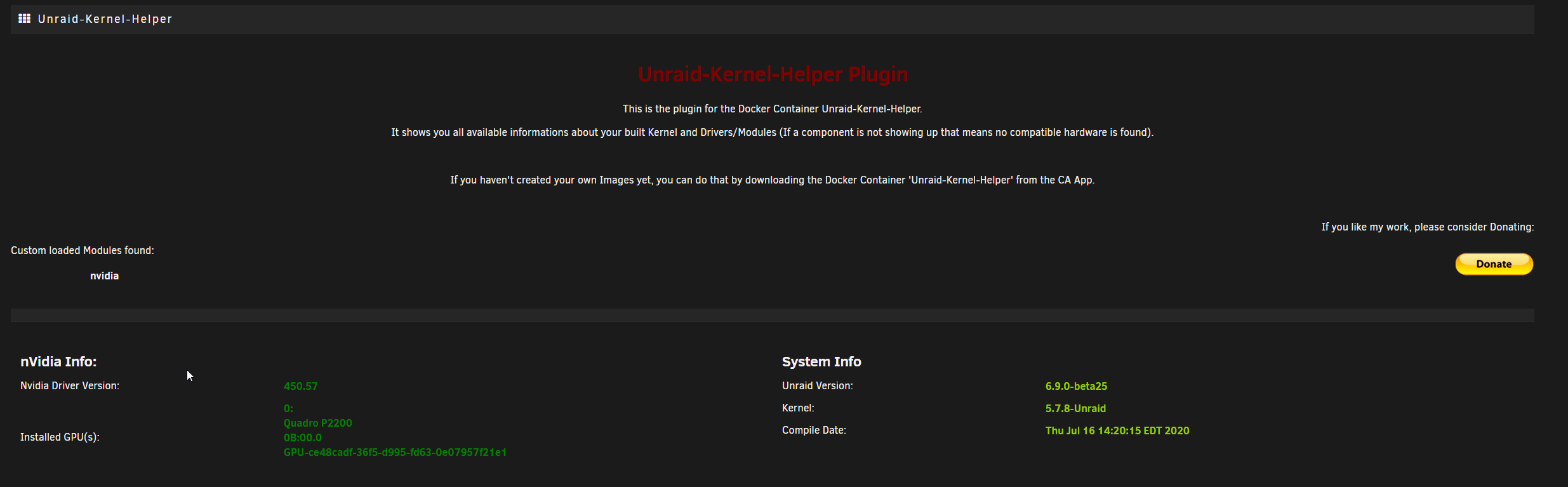

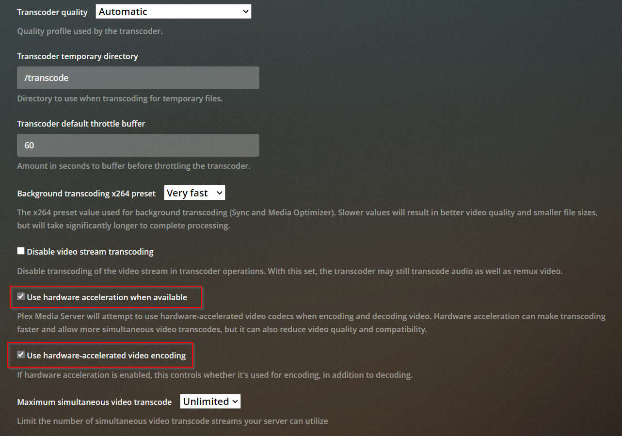

I have been running my P2200 with the Official Plex docker for over a year, no issues.
I am using a compiled Kernel using @ich777's docker Kernel Helper. Outside of that, you just need to add two Variables to your container and then enable HW acceleration from within Plex itself.
Custom Kernel with Nvidia Drivers
Docker Variables I had to add
HW Accell enabled
Proof
