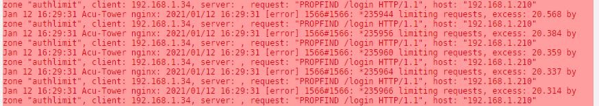

January 12, 20215 yr Hi, I have a similar problem out of nowhere this error starts to appear. It seems that my LOG also fulfills this and the unraid is then slowed down. Does anyone have a solution? The IP address 192.168.1.34 is my PC at home.
