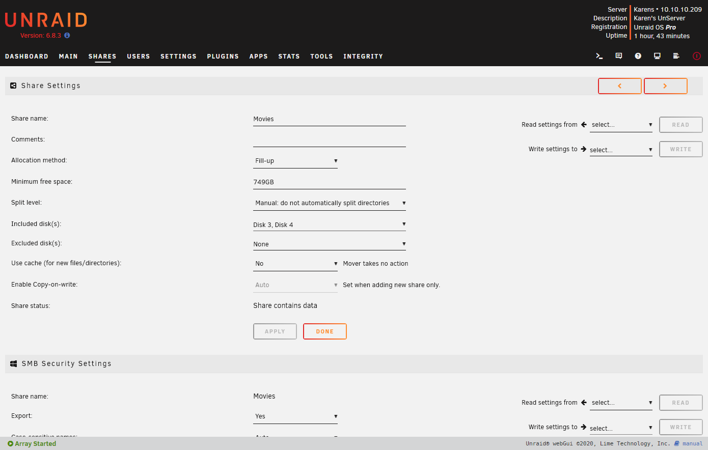

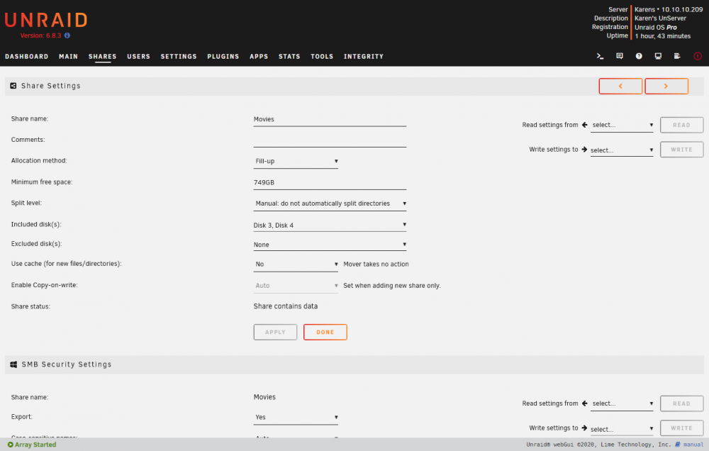

I am a bit confused by the settings you have for Minimum Free on your shares. Can you post a screenshot of the Settings for you Movies share?

58177020_Screenshot_2020-08-13KarensShare.thumb.png.c245499c8303ae7fbcb348cc2561d1ed.png
all 3 shares say all disks, even with prefer applied.
Thats why i had them set to disk 1, thats changed now.  Docker is down to 25g
I want 749gig free on each drive,  windows drives are duplicates. Things still have to be reencoded and replaced.
