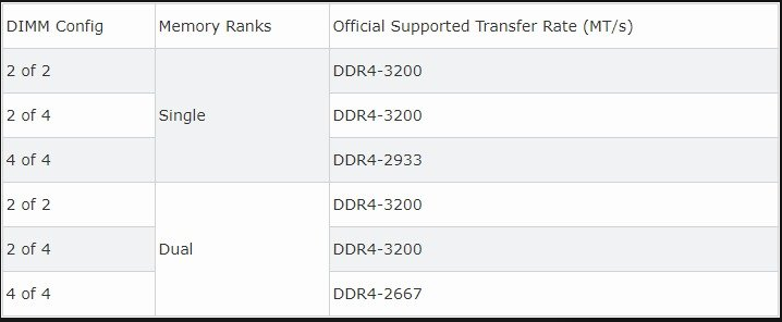

August 14, 20206 yr Author Hello - RAM is set to auto just as I thought so. I couldn't do the memtest86+ from the boot screen. it just kept kicking back to the to reboot loop. so it's running right now. Will update. thanks! Looking into the RAM thing. Ok but how do I read this? I have DDR4-3200. 32GB ripjaws in 2x16 config. AHHH I had it I put the sticks in dual channel mode. Should I put it back in to single channel mode? Would that make a difference? Edited August 15, 20206 yr by cbr600ds2

August 15, 20206 yr 6 hours ago, cbr600ds2 said: I couldn't do the memtest86+ from the boot screen. it just kept kicking back to the to reboot loop. This is know issue, pls setting BIOS boot in Legacy mode ( non-UEFI ) for memory test. 2 hours ago, cbr600ds2 said: mb ram support list Don't be silly, it is not necessary. Pls note you already in single channel mode, you should reinsert the module for dual channel mode then perform memory test. Edited August 15, 20206 yr by Benson
August 15, 20206 yr Community Expert 7 hours ago, cbr600ds2 said: Ok but how do I read this? You have both dimms on the same channel, so it's overloading that channel and running out of spec, it's also running slower than it would in dual channel. You need to to alternate the slots when installing just two dimms, usually they are color codded so both dimms should be on the same color slots.
August 15, 20206 yr Author 7 hours ago, johnnie.black said: You have both dimms on the same channel, so it's overloading that channel and running out of spec, it's also running slower than it would in dual channel. You need to to alternate the slots when installing just two dimms, usually they are color codded so both dimms should be on the same color slots. I did swap it out and its still hanging. Memtest ran for 12 hours and indicated no issues. I'm really curious if its the CPU that took a dump because I keep getting this over and over - Aug 15 09:55:27 Skynet kernel: rcu: INFO: rcu_sched detected stalls on CPUs/tasks: Aug 15 09:55:27 Skynet kernel: rcu: 3-...0: (32 ticks this GP) idle=79a/0/0x1 softirq=81265/81265 fqs=285001 Aug 15 09:55:27 Skynet kernel: rcu: (detected by 10, t=1140034 jiffies, g=471857, q=0) Aug 15 09:55:27 Skynet kernel: Sending NMI from CPU 10 to CPUs 3: Aug 15 09:55:27 Skynet kernel: NMI backtrace for cpu 3 Aug 15 09:55:27 Skynet kernel: CPU: 3 PID: 0 Comm: swapper/3 Tainted: G O 4.19.107-Unraid #1 skynet-diagnostics-20200815-0822.zipsyslog I'm going to run memtest on individual stick...
