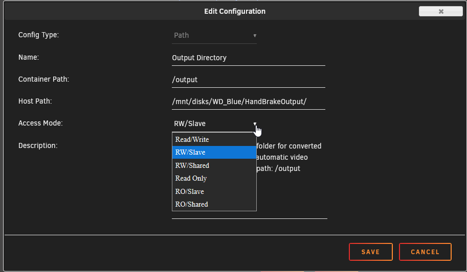

August 14, 20206 yr Hi, so I'm getting the error below and not sure where to find the option to mount it as the slave. They are mounted as SMB network shares, so does that have anything to do with it? Any assistance would be much appreciated. Docker application binhex-plex has volumes being passed that are mounted by Unassigned Devices, but they are not mounted with the slave option
August 14, 20206 yr 2 hours ago, yanksno1 said: Hi, so I'm getting the error below and not sure where to find the option to mount it as the slave. They are mounted as SMB network shares, so does that have anything to do with it? Any assistance would be much appreciated. Docker application binhex-plex has volumes being passed that are mounted by Unassigned Devices, but they are not mounted with the slave option In the docker container configuration, any unassigned devices host paths should be mounted with one of the slave options as seen below in my HandBrake example that uses an unassigned devices for the output:

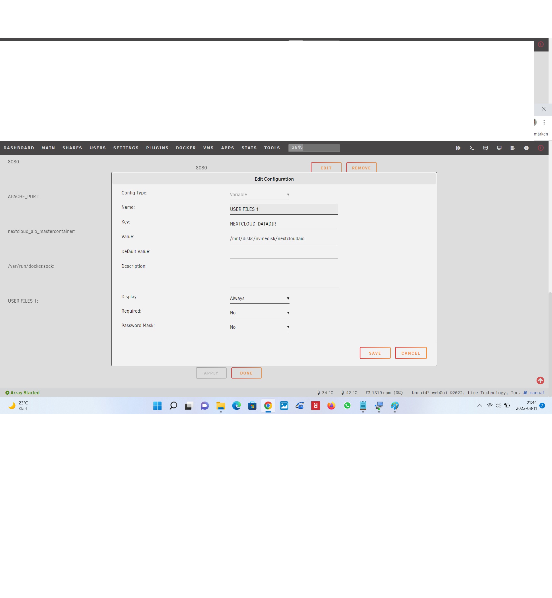

August 11, 20224 yr Hi, how to edit this slave option when in the container configuration there is a Variable (NEXTCLOUD AIO) where the path in mounted not as a Path and you can not do this in the Variable edit option. Thanks for helping.
August 11, 20224 yr 2 hours ago, serch826 said: how to edit this slave option when in the container configuration there is a Variable You don't. slave doesn't apply to variables, only mapped paths.
August 12, 20224 yr That was from the fix errors plugin that inform about this after scanning, but no problem I went back to just Nextcloud docker. Thanks for your time.
