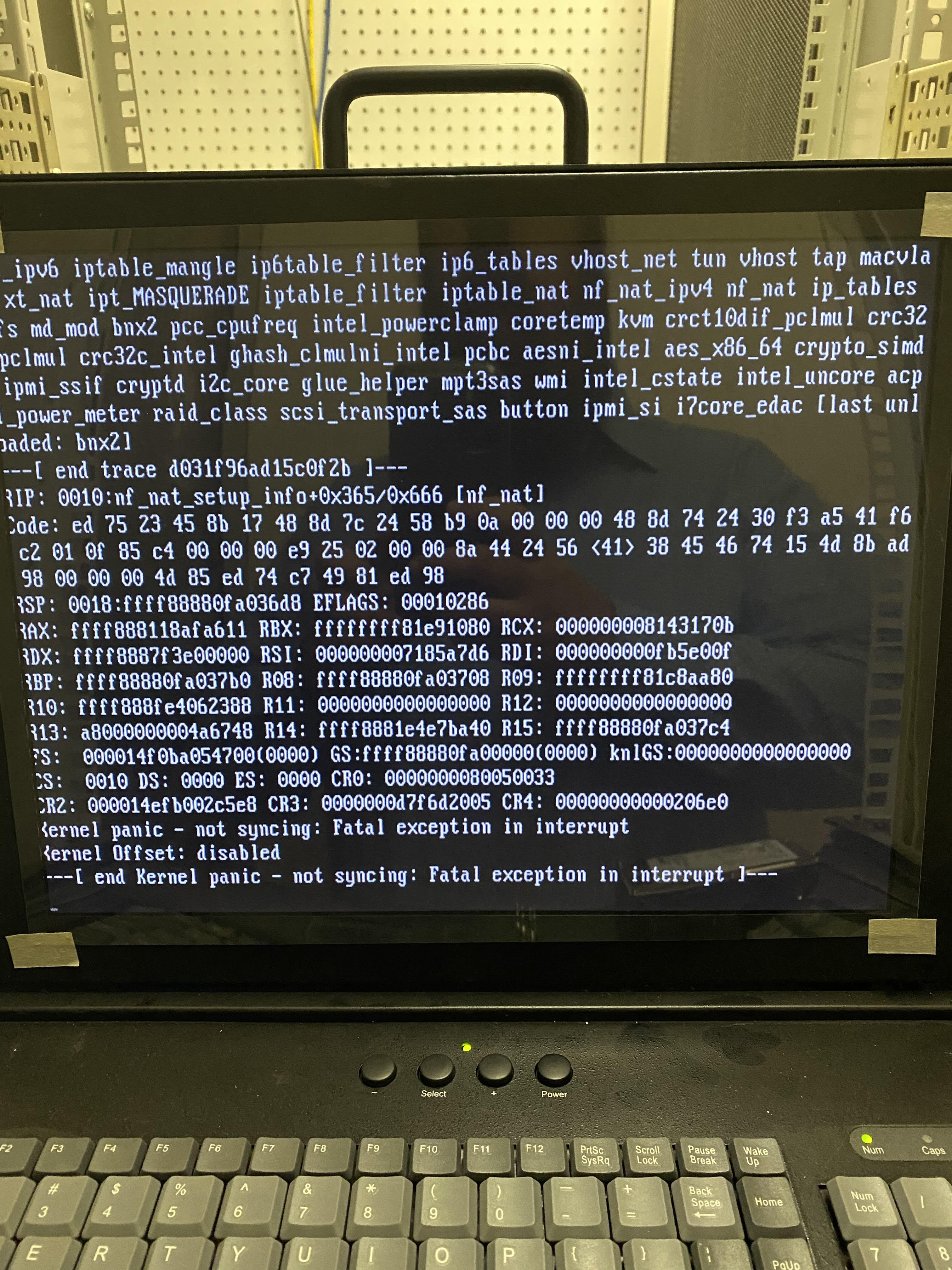

Likely a result of the crashing, not the reason for it, but you need to check filesystem on disk9.
You should also try this, it might catch the beginning of the crash problem.

Thanks! I ended up doing a filesystem check/repair on all my disks and caught some things, thanks for that.

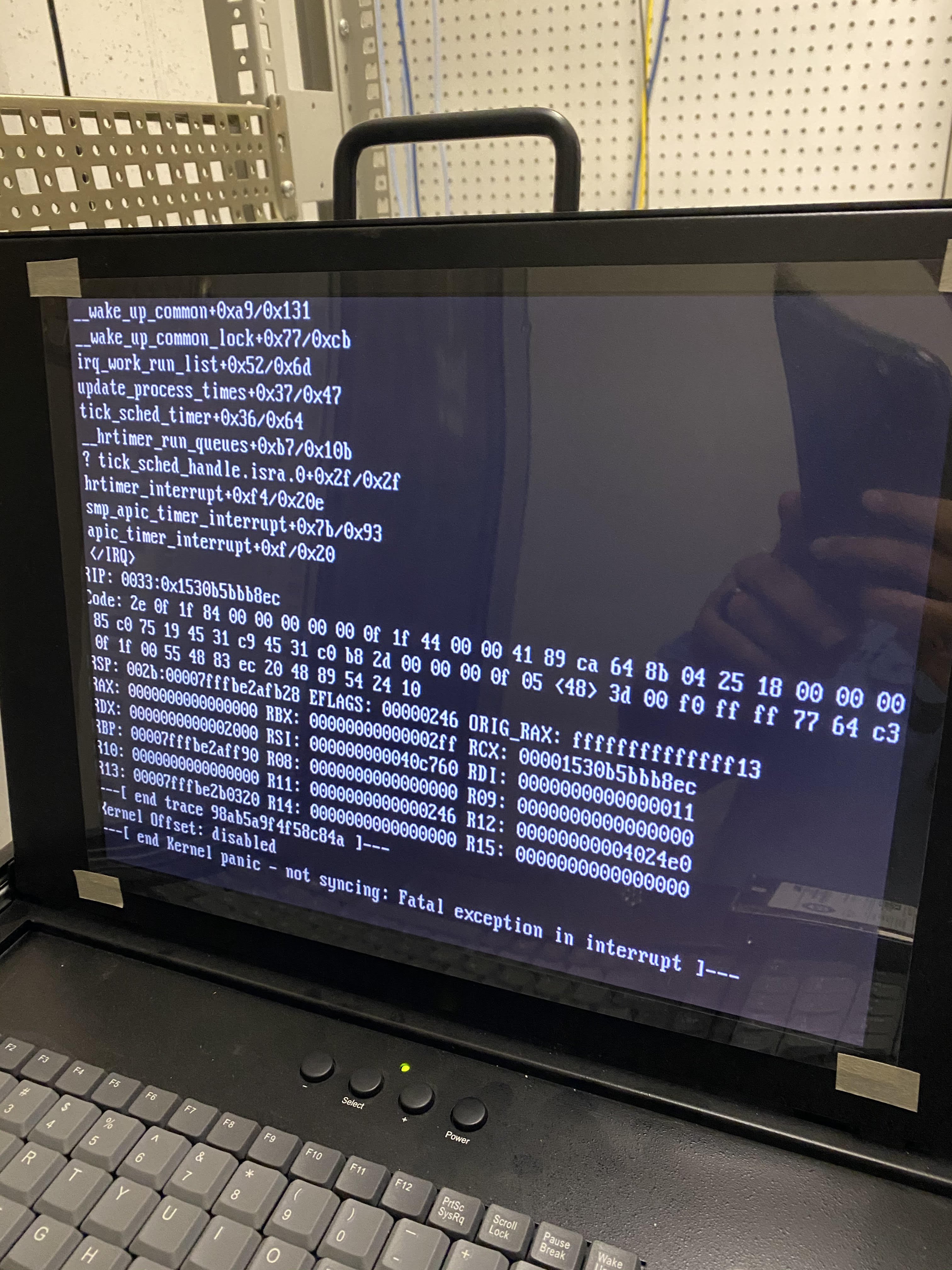

I enabled the syslog server and had it mirror to my flashdrive....hope that was ok. I assume these still get packed up when I do a diagnostics dump? (Attached) The last kernal panic happened August 19 12:45 EST
No syslogs in diagnostics only include since last reboot. You will have to get the syslog server logs and attach separately.
Don't recommend leaving syslogs saving to flash but fine for short term debugging.
I have attached the one located at /boot/logs is this correct?
syslog
6 hours ago, tacobelldog52 said:
is this correct?
Yep.
There are some macvlan call traces, these are usually caused by dockers with custom IP addresses:
