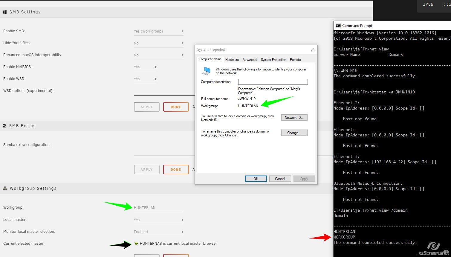

1. I set my unRaid server as Local Master and monitor current elected master (dynamix plugin - latest version 2020.06.20) a long time ago when I first setup SMB.  Its still that way (see black arrow in screenshot).
2. Verified unRaid server AND PC in correct workgroup (see green arrows).
3. From PC ran Net View /domain, curious that I see BOTH HunterLAN and Workgroup in the response (see Red Arrow).  I have other devices on the network (phones, iPad, IP Cameras, Skylight controller, TV's), but none setup with SMB that I'm aware.

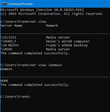

I will first post up my command window from my WIN10 computer:
My Workgroup is name 'HOME'
You show a second workgroup named WORKGROUP.  I would suspect that you have another computer running SMB somewhere on your network as that is the default SMB Workgroup name.  At this point, I would not be too worried about the extra Workgroup.

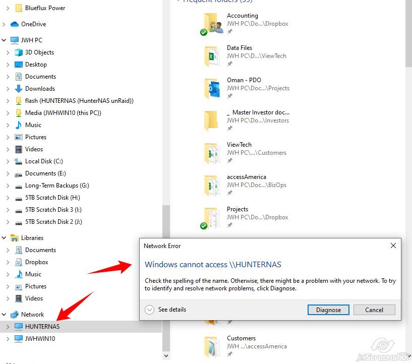

I actually see the HUNTERNAS server in the Network folder in file manager as I always have.  Except when I try to open it, I get "Windows cannot access \\HUNTERNAS (See Screenshot)...

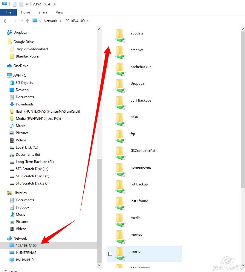

however if I put 192.168.4.100 (the static IP I gave the server), then it works as it should (See other screenshot).  Somehow, \\HunterNAS isn't being translated to 192.168.4.100 in SMB?

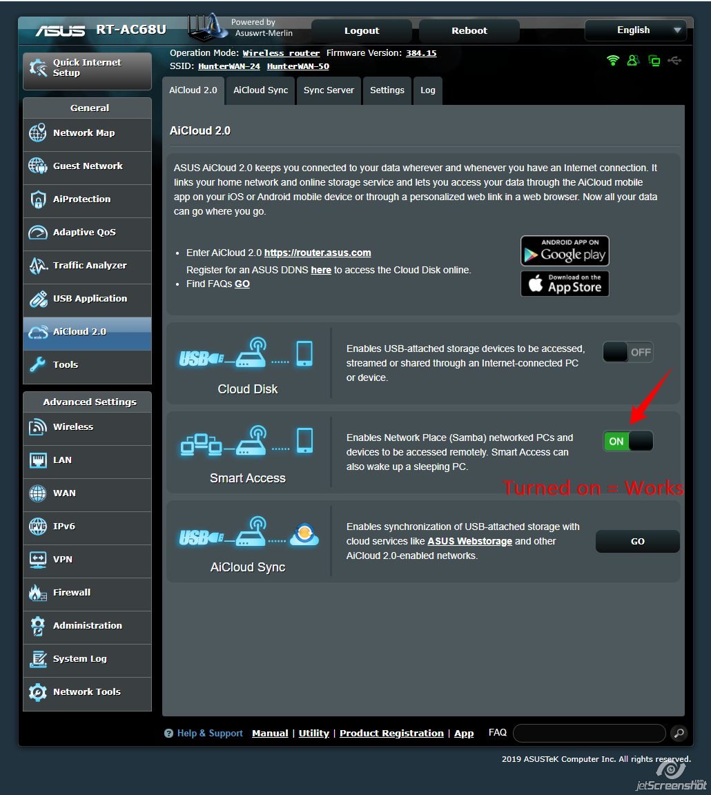

Ok, evidently SMB can be affected by MANY things?  What triggered this problem is replacing a defective router and in the process changing the IP address structure temporarily.  There is an OBSCURE setting in the router called "Smart Access" (see screenshot) when says it enables Network Place (SAMBA) network PCs to be accessed remotely.  When I turned that on, suddenly I can now see my unraid server.  I've made a number of other settings changes to my network, most notably going back to the original IP class address (192.168.29.xxx), perhaps the IP change back to the original setup fixed it (a cache somewhere?).  Regardless, this is now solved.  Could it have been the router setting?  Or cache somewhere?  I hate it when I fix something, but can't identify what I did.
