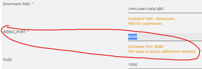

Figured it out.. Had an old docker that also had 8080 allocated(thought it was set to stay stopped) but it wasn't and it was starting before qbit was. Btw so far the experience has been much better than deluge. Downloads are much faster so thanks a lot for putting out a wireguard docker.

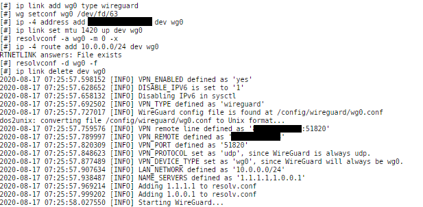

when wg is active, local access is blocked. This includes the webui. I have tried:
  1. changing the webui port from 8080 to another port 7979/8181
  2. editing qBittorrent.conf to change the webui port
  3. manually passing the port as an Extra parameter
  4. giving the container its own ip
  5. adding my local network to the wg conf
    1. when doing this wg does not connect. the error message is "RTNETLINK answers: File exist". see the attached image.
these are the same issues i was unable to over come in my post here:
when wg is off or openvpn is used. no issues.
12 minutes ago, rukiftw said:
please note that in order for uploading to work:
  1. you have to have port forwarding through your vpn provider and setup the client to use those ports
  2. upload speed will be based on your vpn's location and your speed to it.
@rukiftw I'll investigate. Are you running the container in Bridge mode or with an own IP (like br0 custom IP)?
@Dyon i have tried both ways.

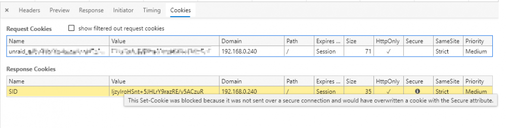

I change the default admin password through qbt webUI. When I tried to login to the webUI with new password, I keep getting rejected. The login screen just keeps refreshing when clicking on Login
yea test speed and it shold be ok it work now some time but fell more bad TorGuard vs PIA as I use before sadly there some problem with it at the moment. any way thx
Could you check if you would be able to log in using a In-Private/Incognito window?
Edit: I was able to replicate the issue. It seems to be a caching issue from a browser.
If you use Chromium-based browsers (Google Chrome, the new Microsoft Edge, Brave), Press F12, go to the Applications tab, select 'Clear Storage'.
Note that this will also clear the cookies related to Unraid itself.
Edited by Dyon
I'm sorry, but I havent been able to replicate your issue. I only get the message 'RTNETLINK answers: File exists' if I use a custom IP (which is, as a side note, not recommended).
Could you maybe tell more about the setup that you are using?
Did you keep the Docker settings as default? Does the WireGuard config work on other devices like your PC or Phone?

1 hour ago, itlists said:
Thanks. Any workaround for this other than clearing unRaid cache?
Unfortunately it seems to be caused by some policy of browsers.
I think this is what causes this issue:
If you have a Docker that hosts an application with the same Cookie name that qBittorrent also uses, called SID (session id cookie), it is unable to overwrite this cookie because qBittorrent is by default http, and a http website can not overwrite a https cookie.
See also this error message from Chrome.
I'll look into generation of https certificates by default of this Docker to bypass this.

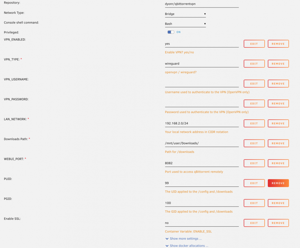

I've pushed an update to the container.
  • The container will now check if the new environment variable called ENABLE_SSL is set to yes, if so, it will execute checks and fix the config to make it compatible.
    • By default this is set to 'yes' if you use the new template, which should be live within a few hours on CA.
If you would like to Enable SSL/HTTPS now please do the following:
  1. Update the container
  2. (Stop the container)
  3. Edit the container
  4. (bottom of page): Add another Path, Port, Variable, Label or Device
  5. Config type: Variable
    1. Name: ENABLE_SSL
    2. Key: ENABLE_SSL
    3. Value: yes
    4. Press add
  6. Scroll up to the top right and set the slider from basic view to advanced view
  7. Change 'http' in the WebUI section to 'https'
  8. Apply
  9. You should now have the container running with https.
