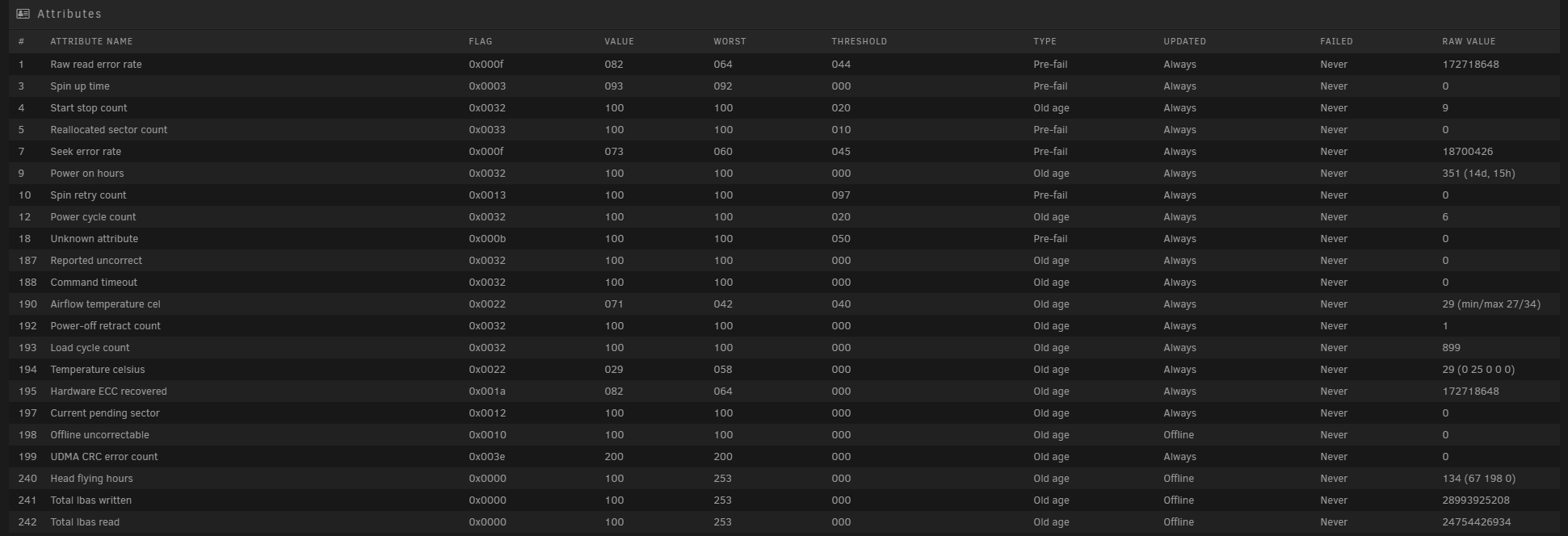

August 17, 20206 yr Hi Guys and girls i need some advice if possible. I had to replace my Hard drive on the unraid because the system where saying that the drive is Faulty. I replaced the drive and put it into a other syste mand tested it and the software found now problem with it. I have replace the cabled but it still complained that the drive was pre fail. The new drive is brand-new and if i looks at the drive it also brings up pre fail why is that.

August 17, 20206 yr Community Expert Disk5 looks healthy, what do you mean by this: 3 hours ago, Morne said: it still complained that the drive was pre fail. Where are you seeing the disk is failing?

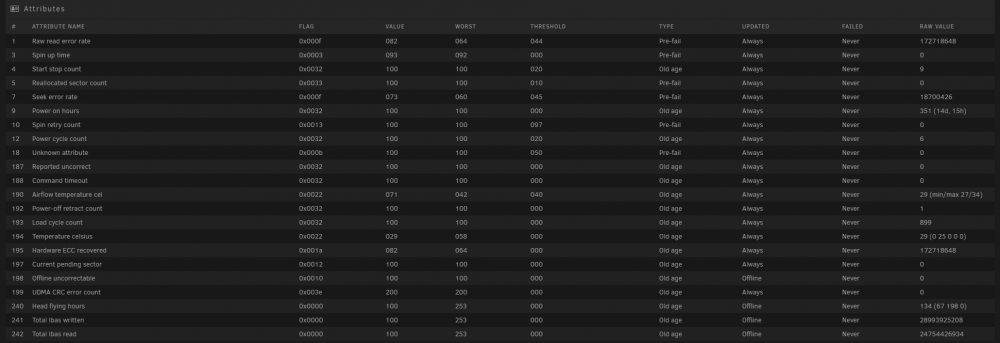

August 18, 20206 yr Author This is what i am seeing and sorry if it is not anything serous. I have removed the 3 TB drive 2 weeks ago and added this 6 TB drive that is brand new. On the 3 TB i ran some tests and it is not finding anything wrong with the drive.
August 18, 20206 yr Community Expert All is well, pre-fail you see is just the type of the attribute, the important part is the failed column (and the values themselves).
