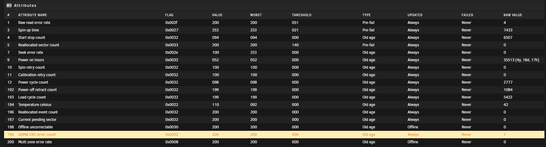

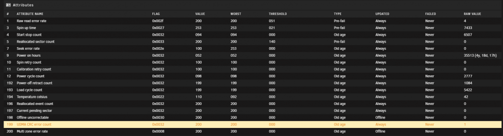

I do see this error, could this be the issue?
I noticed this hard drive is also hotter than the others.
Edited by sublime24
CRC errors are usually connection issues. A small number not increasing is nothing to worry about.
Just acknowledge the CRC error by clicking on the "thumbs down" on the Dashboard. It will warn you again if that increases.
