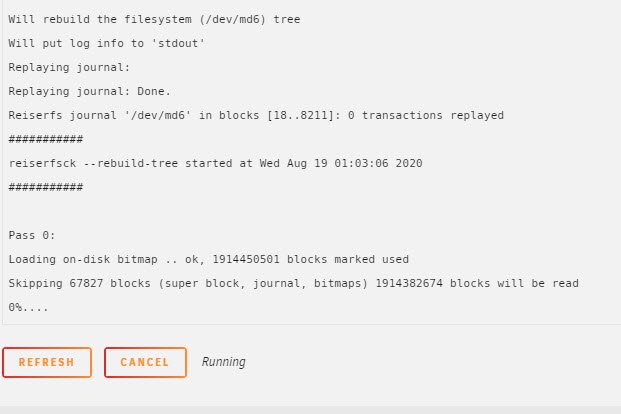

i checked the filesystem on disk 6 and it said to run the --rebuild-tree option, so i started it.
How long does it take around, it has been at this screen for almost 2 hours
Depends mostly on the disk size, around 2/3 hours per TB.
