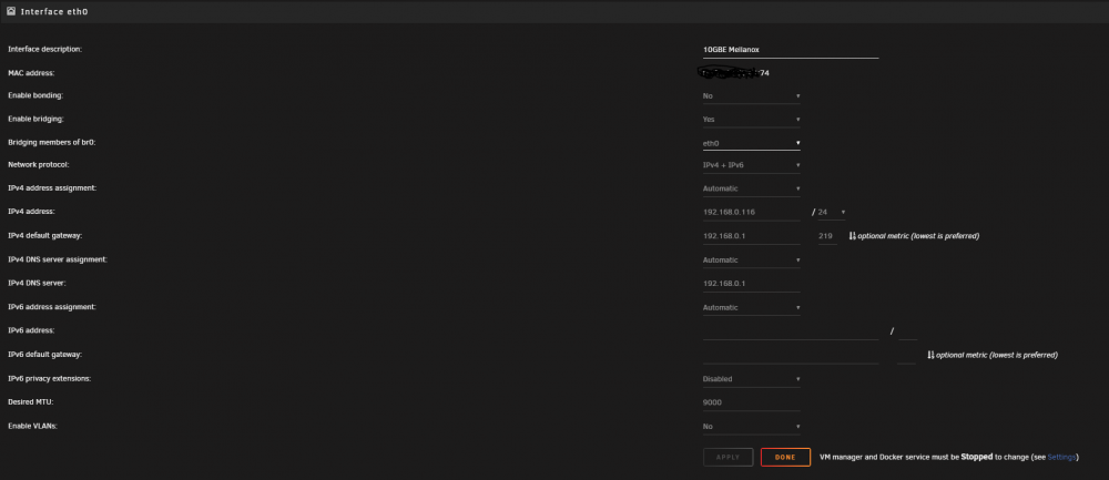

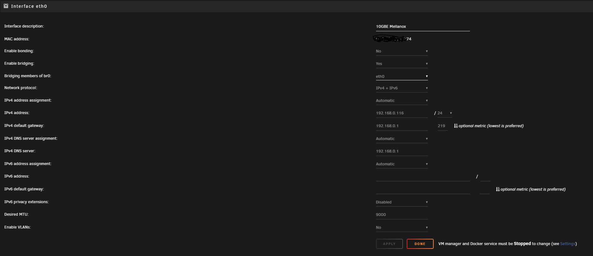

I manage to switch Eth0 to the mellanox card, gave it an Ip adress, reboot, and I see it, can ping it. Webui is accessible to that Ip.
.... BUT
As soon as I unplug the rj45 from the old main nic (Which is eth4 now), I lost every connection. The mellanox is still pingable but Webui not available at all.
I plug back the Rj45 to eth4, everything work again, AND I can access webUi with both of the Ip of eth0 and eth4.
As I try to see where the traffic is going between both of them, I clearly see the Mellanox Ip is doing the job at 100%, not data through eth4 so far, every docker app transfering to LAN an web via eth0 (mellanox and correct Ip assigned before)

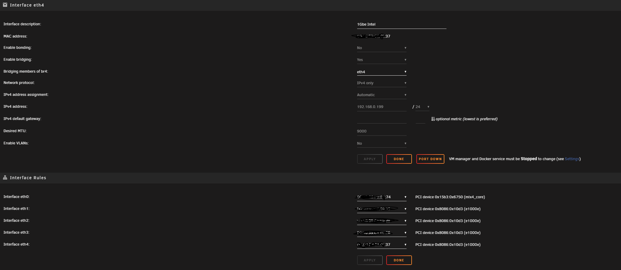

Eth4 Mac is **:**:**:**:**:37 branded ASROCK Inc, shown under an Ip 192.168.0.116, Ip assigned to the mellanox Nic. The other Ip (originally assigned to the eth4 get the same Mac (**:**:**:**:**:37 branded ASROCK Inc, show under an Ip 192.168.0.233
