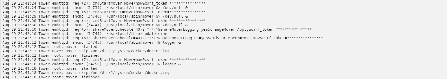

It's supposed to run daily but it still has 135gb on it.... anyone can see based on below what I am doing wrong?  Files are just movies and it looks like downloaded art so it shouldnt be in use.
Typically you want files related to dockers / VMs to stay on cache so their performance will not be impacted by parity updates and so they won't keep array disks spinning.
We can get a better idea of your situation from the Diagnostics.
Go to Tools - Diagnostics and attach the complete Diagnostics ZIP file to your NEXT post in this thread.
You have a share anonymized as H----------k set to cache-prefer. Prefer means try to keep files on cache. Is that what you intend for this share? Or do you really mean for it to be moved to the array? To get it moved to the array you must set it to cache-yes.
Your isos share is also cache-prefer. Since that share is normally used for iso files used to install VMs, but not actually used while running VMs, that one can be moved to the array also (cache-yes).
Doesn't look like you actually have any VMs.
The shares that should be on cache and set to stay on cache are appdata, domains, system. These are all cache-prefer, which is good, but system has files on disk1. Possibly you enabled dockers before installing cache, so docker.img got installed on disk1 instead of on cache where it needs to be.
Mover can't move open files, so that is why it isn't getting moved. In fact, it is really better to just delete docker.img and recreate it. Then the Previous Apps feature on the Apps page will reinstall your dockers just as they were.

Thanks!  I will try to respond in order:
-H--- ---K.  I didn't know the difference in cache yes and cache prefer.  I have switched it to cache - yes
-isos switched to cache yes
-No vms yet this thing is a glorified movie holder at this point but I am trying to learn new things like running servers on it etc.
***I do see Docker image on disk 1.... ITS 21gb?? I only have like 4 docker programs.... is that normal?  So I just delete that reinstall and everything should be good to go?  If so awesome and thank you!
Could this have something to do with how my settings for config files in dockers are?  I set them to mnt/user/appsdata etc.  I see some settings had mnt/cache/appsdata etc but I thought I read that was wrong somewhere..
I really appreciate the help.
@trurl  Just an FYI it's all working.  Just switching cache to preferred moved the docker image over over night and then everything else went.  So a huge thanks.  I only see a libvirt image in system files now but I am guessing that will go to.  Thanks again!!!!
