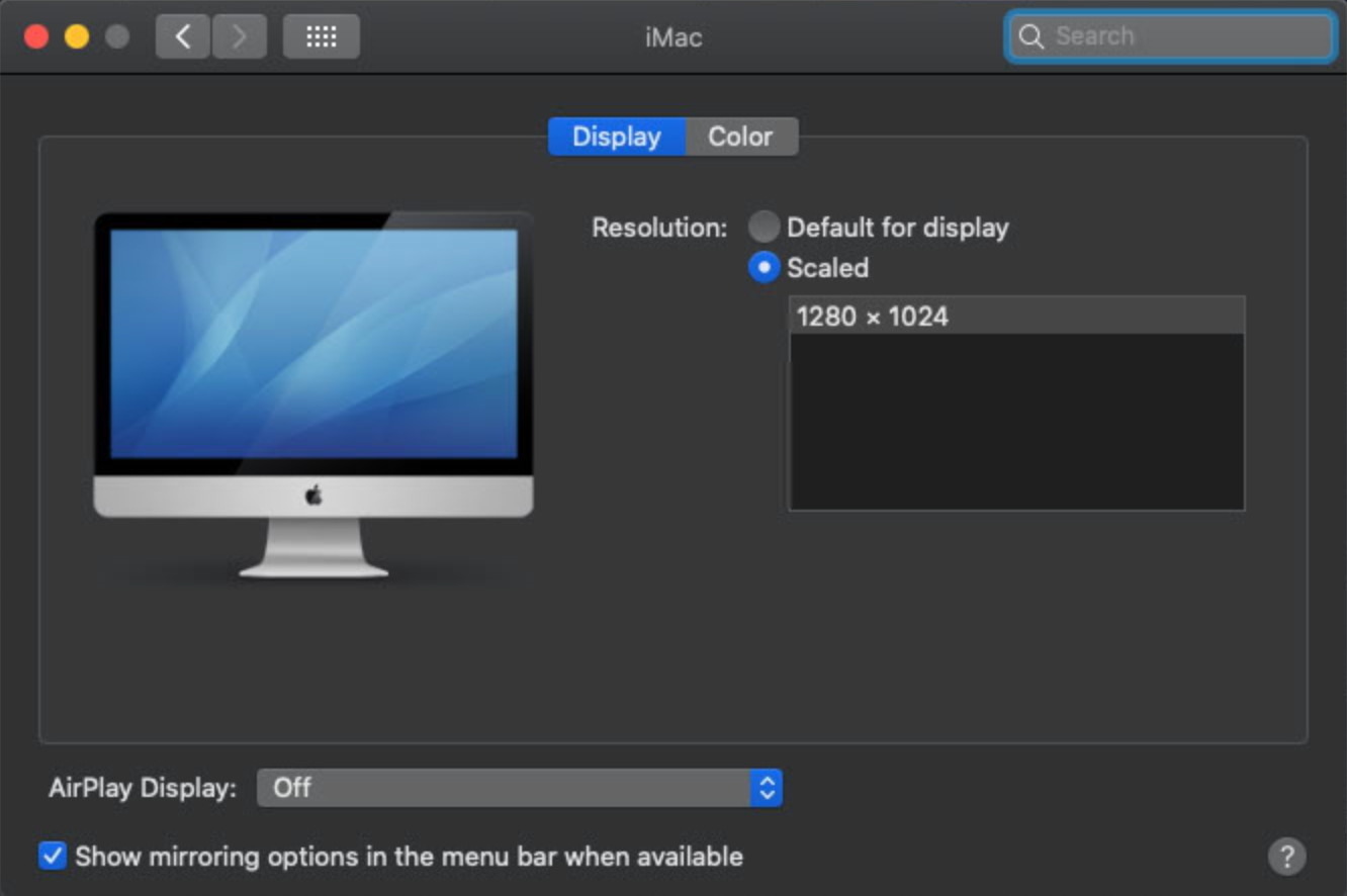

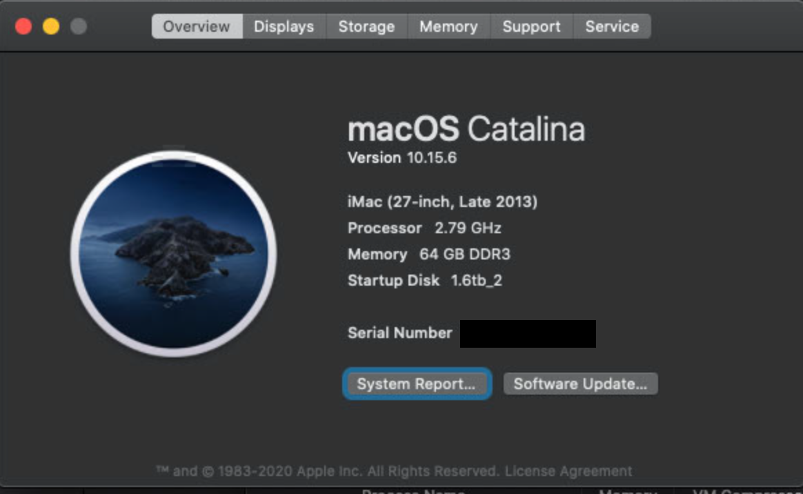

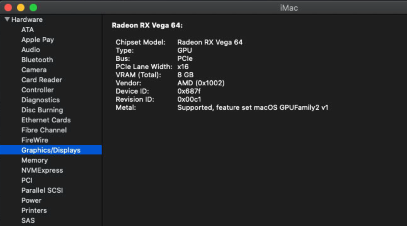

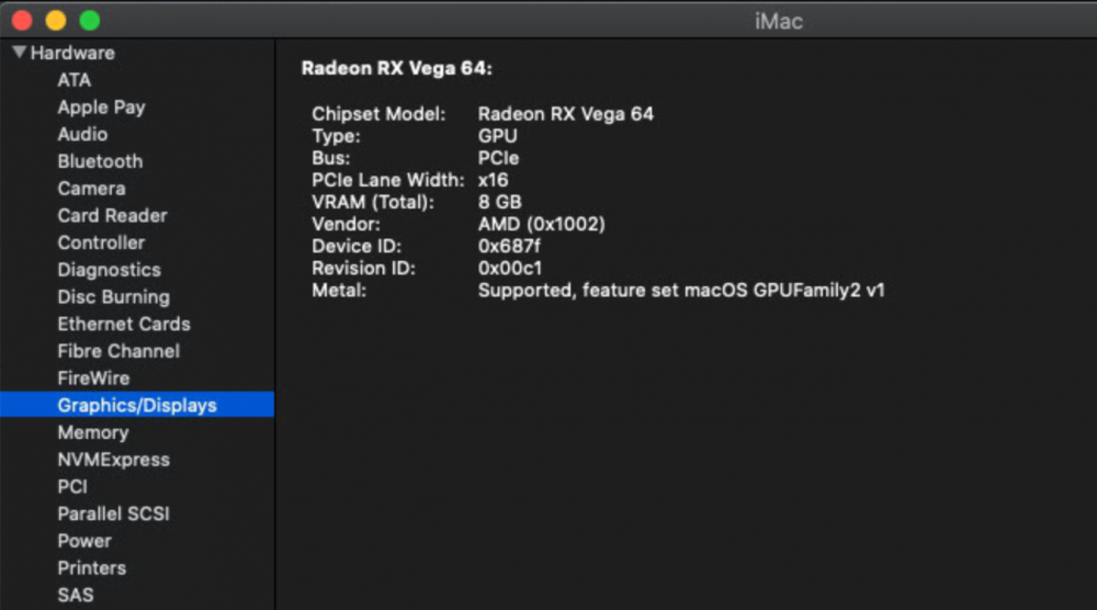

So (I have the problem of the Vega 64 not working on VM reboot, so that exacerbates the problem, but) the main problem is that it doesn't actually display out on the monitors - the VNC server is still running, and I can log in, but under About This Mac, the graphics line is missing, but it is under the System Report, however, the monitors aren't there, and it only lists a built-in monitor at 1280x1024.  fwiw, the machine shows up as a late 2013 imac 27" :-/
The frustrating thing is that 10.14 works normally...  I'm a little hesitant to start over with the Macina from Space Invader One because I feel like this ought to be something I can make work X-D
