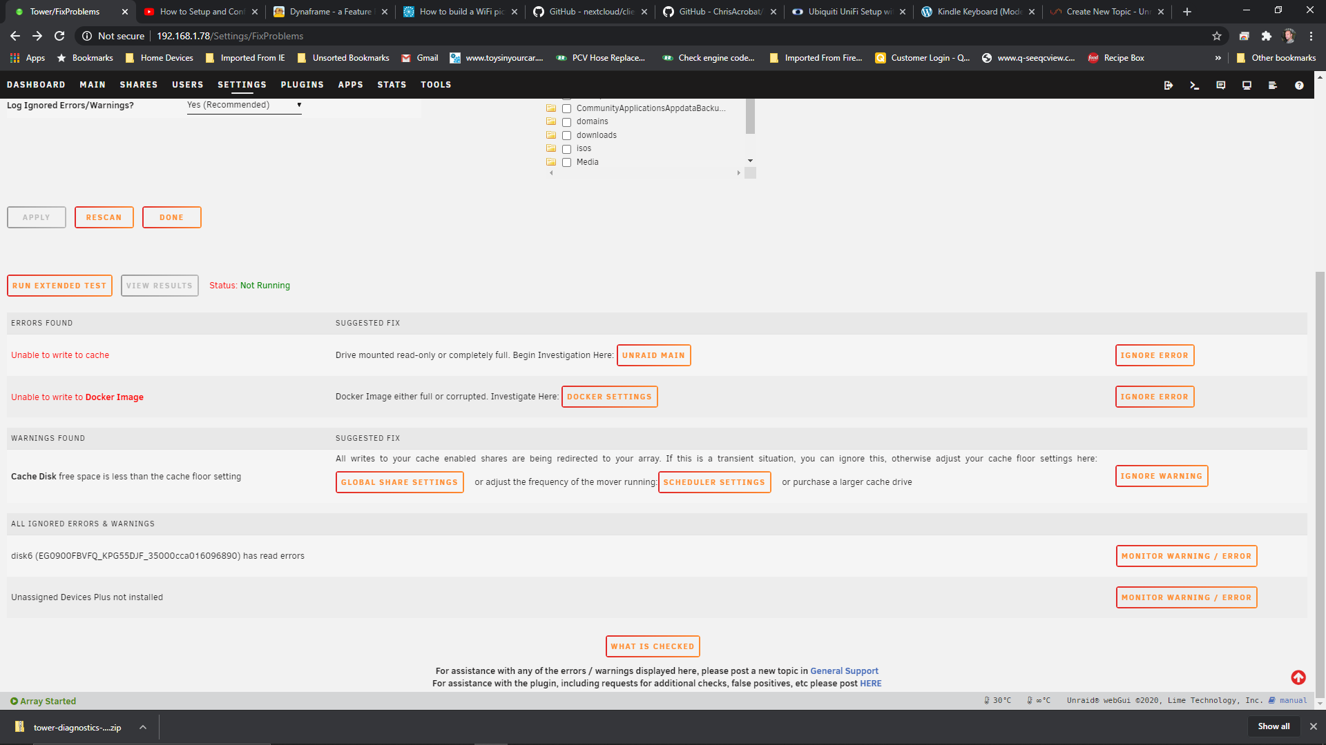

I did that and it worked fine for 24 hrs however now the service will not start again and it says the cache is write only and the docker image is full but Docker is at 36% and cache has 170gb free and no one has set it to read only.
Here is the screen shot from the Fix Common Problems plugin and the zip files containing the diagnostic logs

johnnie.black addressed the main thing, but some other things to consider.
8 hours ago, richland007 said:
power outage that lasted for 4 hours and obviously killed the batteries on the UPS which was not configured with auto shutdown
You shouldn't run for long on batteries. The point of having batteries is so you can cleanly shutdown, not so you can keep running. Is your UPS compatible with the APCUPSd builtin to Unraid?
Why do you have 50G allocated to docker.img? Have you had problems filling it? 20G should be more than enough, but I see you are already using 18G. I suspect you have some application misconfigured and it is writing to a path that isn't mapped.
Also, your system share has files on disk1 instead of all on cache. Possibly this happened when you recreated docker.img while still having cache problems, or maybe you enabled dockers / VMs before you installed cache. Your dockers/VMs will keep those files open, so array disks can't spin down, and they will have their performance impacted by slower parity.

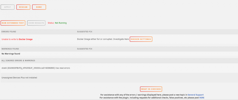

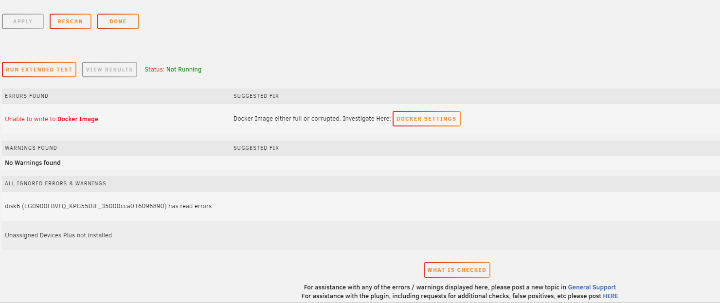

Ok gentleman i removed some files from the Cache and run the balance and got a successful message although the empty space seems to have decreased
(I am having a hard time comprehending this) i have turned off everything VMs and Dockers.
I run fix common problems and this is what i got .....that the docker image might be full or corrupted. I did try to turn the Docker service on briefly and i got the Docker Service failed to start so it turned it back off.
What do we do next?? Should i delete the Docker image again?? What did this fix because i have a feeling that if i delete the image and start installing the apps again the same thing will happen all over.

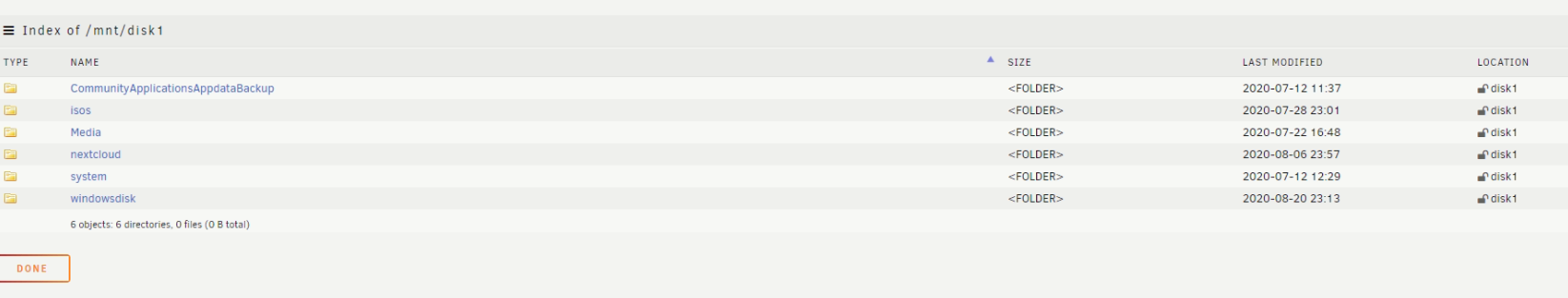

First we need to figure out what is on disk1 in the system share. You really want all of that share on cache but diagnostics is showing some of it on disk1.
Do you know how to examine the disks?
Do you have any VMs?

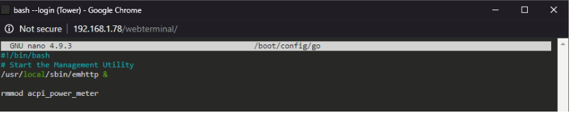

I did the modification of /boot/config/go to include the rmmod acpi_power_meter and rebooted when i rebooted the Docker service was set to start and before i  started the array i checked there were no ACPI errors when i started the array and the Docker service started automatically i saw the ACPI errors  started surfacing up again. How is that correlated somehow cause i thought we are dealing with hardware os level stuff not Docker....... and i made sure that it had saved the change on the /boot/config/go file to include the rmmod.
So in other words the spamming error still remains even though the config is modified to kill the acpi_power_metering...how??? it is beyond my understating ability LOL
i did examine the disk and yes there is a vm i am trying to run on disk1 system folder...is it supposed to be there?? how do we move that an others it in order for the spin downs to occur .

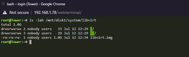

From the command line, what do you get with these?
ls -lah /mnt/cache/system
ls -lah /mnt/disk1/system

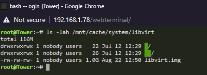

ls -lah /mnt/cache/system/libvirt
ls -lah /mnt/disk1/system/libvirt

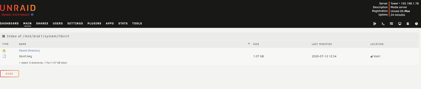

Here is what i am getting for the above commands  .... looks like the same file but different sizes...by the way i used to have a VM that disappeared at the same time with my dockers the first time and i tried to recreate it again.
Thank you
Denis
That seems to indicate that the version on cache is the currently used one, as it should be. You can delete the system folder on disk1.

Hey thank you for the quick response...
That seems to be the copy of my old VM that i lost how do i use that to get my VM back .....i have been browsing all over but i keep reading about the old xml file that i dont have
