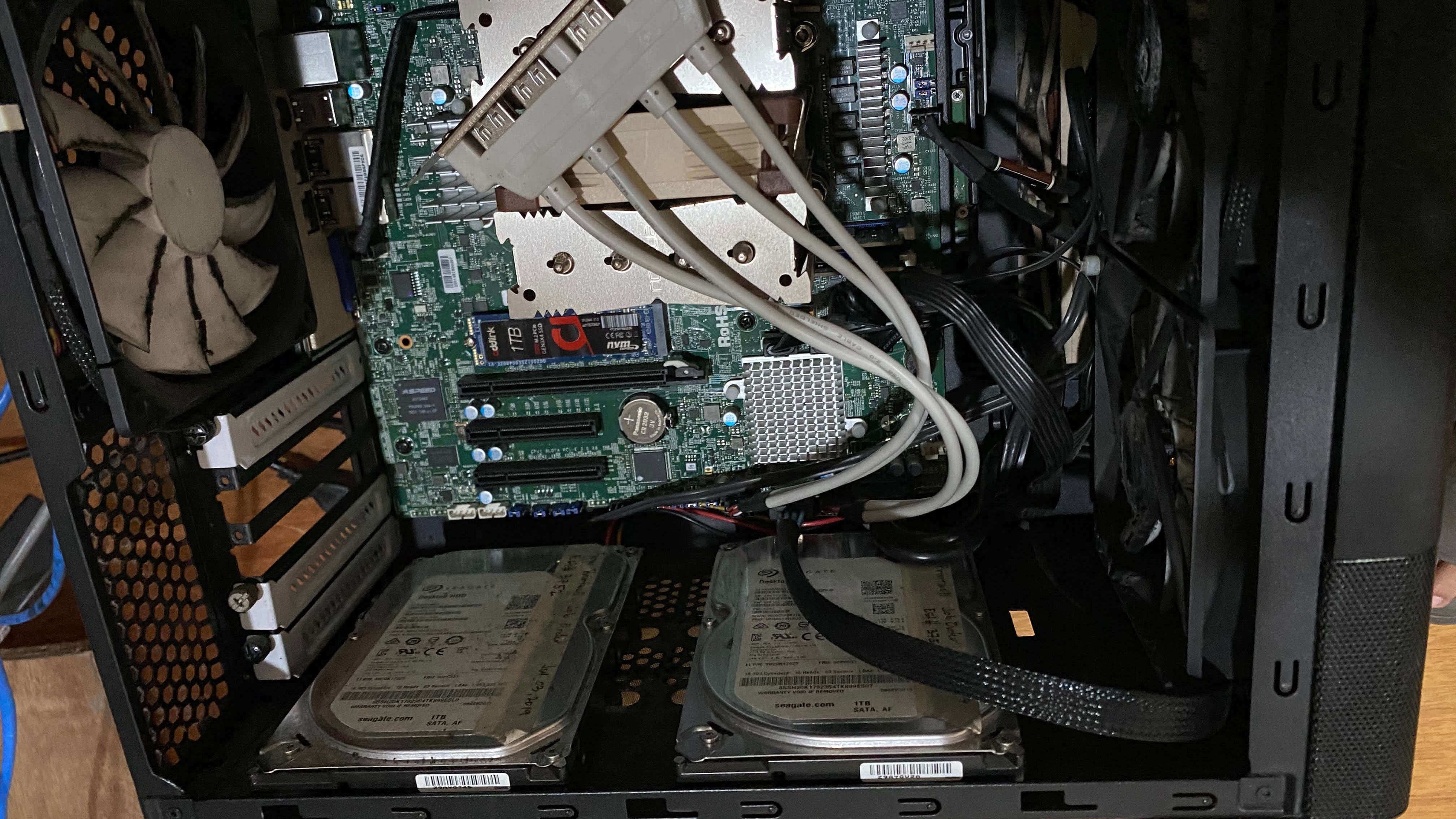

Can't tell clearly from the pic but I don't think the 1st PCIe x8 slot is open-ended so it won't fit a x16 length card.
The 2nd PCIe x8 slot could be open-ended but need a better closer picture to tell.
In terms of transcoding, the popular Quadro P2000 is single-slot width and not that long so could fit on the 2nd x8 slot (assuming it's open-ended).

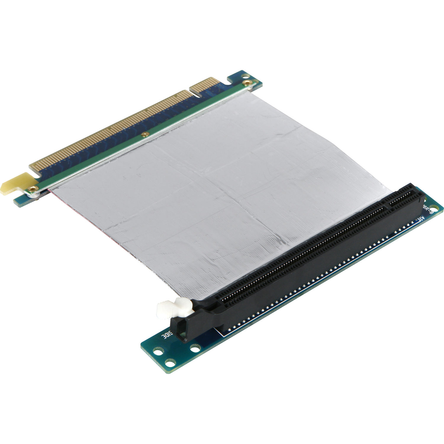

Hi.  They are both closed.  And I really don't want to hack it off :D  As mentioned, almost perfect board.  What do you have in mind?  I do have a hard pcb riser where I can plug x16 card, and converts to x8 slot.  that will make may video card taller, but I can manage to screw it to the case, or Zip tie.  I've done this before.  But I've done some research.  GTX1050 can transcode h265.  Most cards are 2 slots.  If I were to use that method, I'll have to remove the bottom 2 HDDs shown here, or I don't think it will fit?  Or will it?  In another thread, I discussed the idea of moving my existing GPU 1 slot to the right, on top of my m.2 SSD, using something like below:
Not sure if I'll be able to bend the ribbon properly though.  That will allow me to use the 1st x8 slot to put in another GTX 1050 gpu for emby.  Is this a good idea?

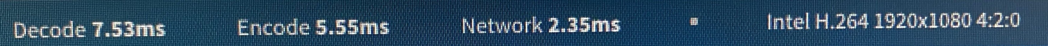

Pressing CTRL+SHIFT+M brings up the menu but shows the streaming stats.
I'm showing 4-7ms encode + 3 ms decode, network <1ms so should be good for 100FPS, capped at 60. the combined latency is less than 1 frame.
I did have to increase mouse sensitivity in game as free look was slow but that fixed it.
There is the odd hitch, a freeze for half a second, every couple of minutes but that seemed to conincide with seek noises from the array drives which are pretty old at this point. The rest of the time it was perfectly playable. I also haven't done any optimisation yet as I've deleted a lot of broken VM's.
I did find less hitches with 4c8t than 2c4T.

Is the streaming stats what I need to show how I'm doing?  I have this before-
1103723843_IMG-3118(1).thumb.jpg.7248d1e88547a3629640f7549ec0c0a7.jpg I capped settings in Parsec to 60 fps.  Why is yours better than mine?  I'm connected to wired network.  How do you check combined latency?  I set mine to 50 Mbps.
Since I don't play fps games, I have to rely on kids' feedback.  The only feedback I get is it's laggy :D  Which doesn't help at all.  Let my try to get them to test some more, and elicit more feedback.

Total latency is Encode + Decode + Network.
This should be below 16ms total to obtain 60FPS as each frame takes 16.67ms. Ideally you want a little headroom. Pushing up the bitrate may increase latency as more date physically takes longer to encode, transmit and decode.
Yes, I read about this this afternoon.  I pasted logs above, just in case you know how to read it.  Don't know why, but today's performance is way better.  Though in the logs, about 19:43 time, I have N:487/230/0, this while my son was playing League of Legends.  I saw on faq, if not near 0, is not good.  But at 21:25, playing cities skylines, I have N:5/2/0, which I had a very good experience.
Not sure if on discord, they help troubleshoot such stuff.  I'm close to nailing this, I think :D
A little more experimentation.
The N: numbers you have are network retransmits, which would indicate a network issue when they are high or that you have a lot of other traffic. I'm getting N:0/0/0 consistently even when I'm connected Via an ethernet on a WIFI mesh network (used as a bridge).
The J1900 plays quite well, though it stuggles at 1920x1080 since decode is ~10ms, at 1280x 800 decode is a more reasonable 4ms and its playable.
